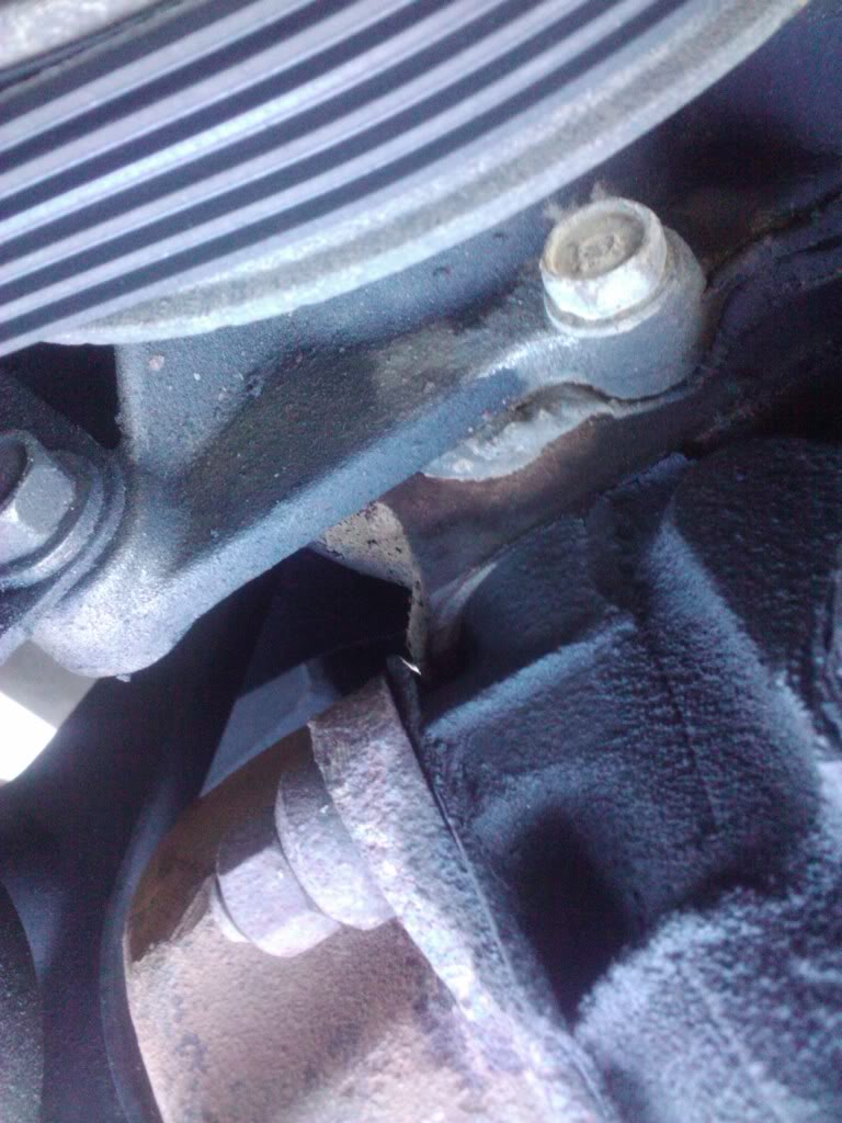

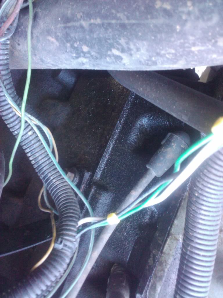

ok, am planning my head /water pump job and did some more reading and it seems that a 4.2 head on a 4.0 block should not line up perfectly, hence the reason for people sealing off the water jackets. this prompted me to pop the hood and check out my engine again as i never noticed any over hangs or lips around the block head mating surface. i still don;t see one now. can someone look at the pics i have and tell me if this is a 4.0 or 4.2 head on top of my 4.0 block?
this is to verify, besides by the numbers, that its a 4.0 block. no fuel pump spot

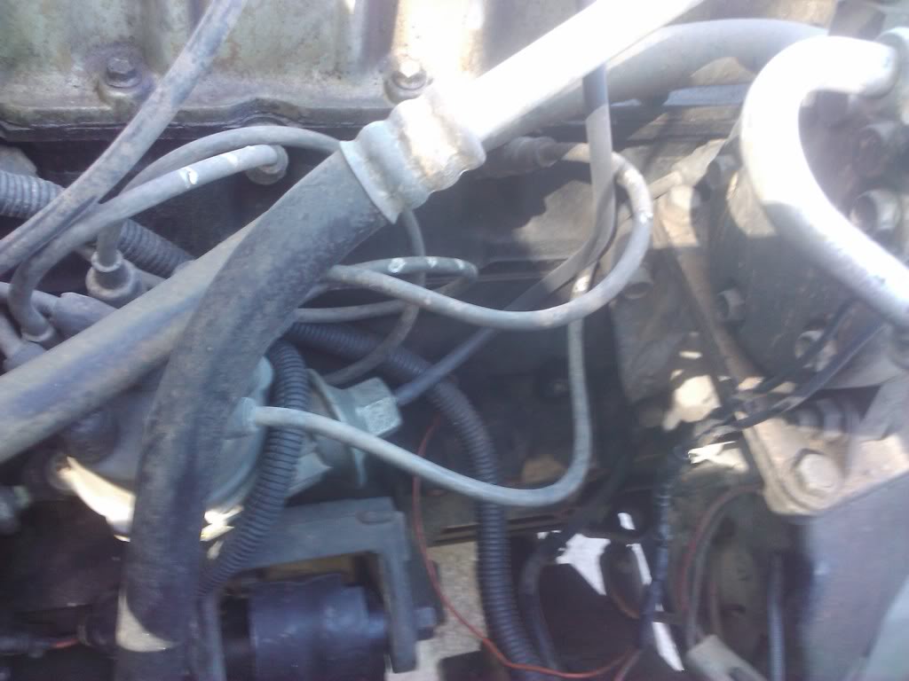

top view. looks like a 4.2 to me but i am no expert
passenger side rear, no over hang
driver's side front, no over hang
i have looked at pages and pages of pics but i must not know what to look at to tell. there are so many different valve covers and hose configurations on people's different engines that i don;t know what i have

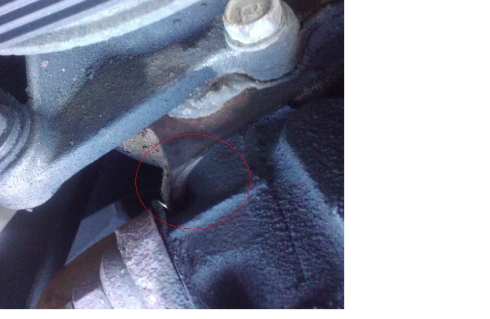

see in that last picture, i circled it in the red
that looks like a line from a different head being on this block. since the 4.0 head over hangs on a 4.2 block, that could be the 4.2 head not being as large and covering as much on the 4.0 block.

Look between the second and third cylinder on the right side above and slightly to the left of the fuel pump.

i have no fuel pump. my block has no mount for a fuel pump and i don;t know where to look other then between 2 & 3. i will look later as i am kind of bummed out that i started working to pull the water pump and sure enough, the pump the parts place gave me doesn;t match and there is not one closer then houston. they'll have it here tuesday.
ok, went and looked around and hte block is an 88, not a 98. so my stroker dreams are not whats going on. last time, i guess the shadow made it hard to see the bottom of the 8 because i brought a super bright light out this time and it is indeed an 88 block.
nothing on the head in the spot mentioned for numbers though. i looked all over for it. and also, no spot for a mechanic fuel pump either. what the heck does that mean?
nevermind, got the camera in close and its a 98. Still don't know why the 98 water pump won't fit nor what year the head is
