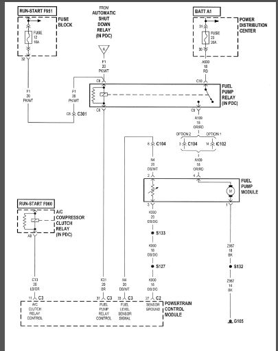

Jeeps are pretty easy to troubleshoot -
1) Scan or codes. post all codes
2) Check Fuel pump fuse and relay. Underhood PDC - fuse #23 and relay
NOTEs
Hopefully there is NO remote starter a POS very problematic.
Get and Use a fuel pressure gauge,
Always get sensors from jeep
Where or what brand crank position sensor? Some are bad out of the box and will not initiate the fuel pump without a working Crank sensor.
