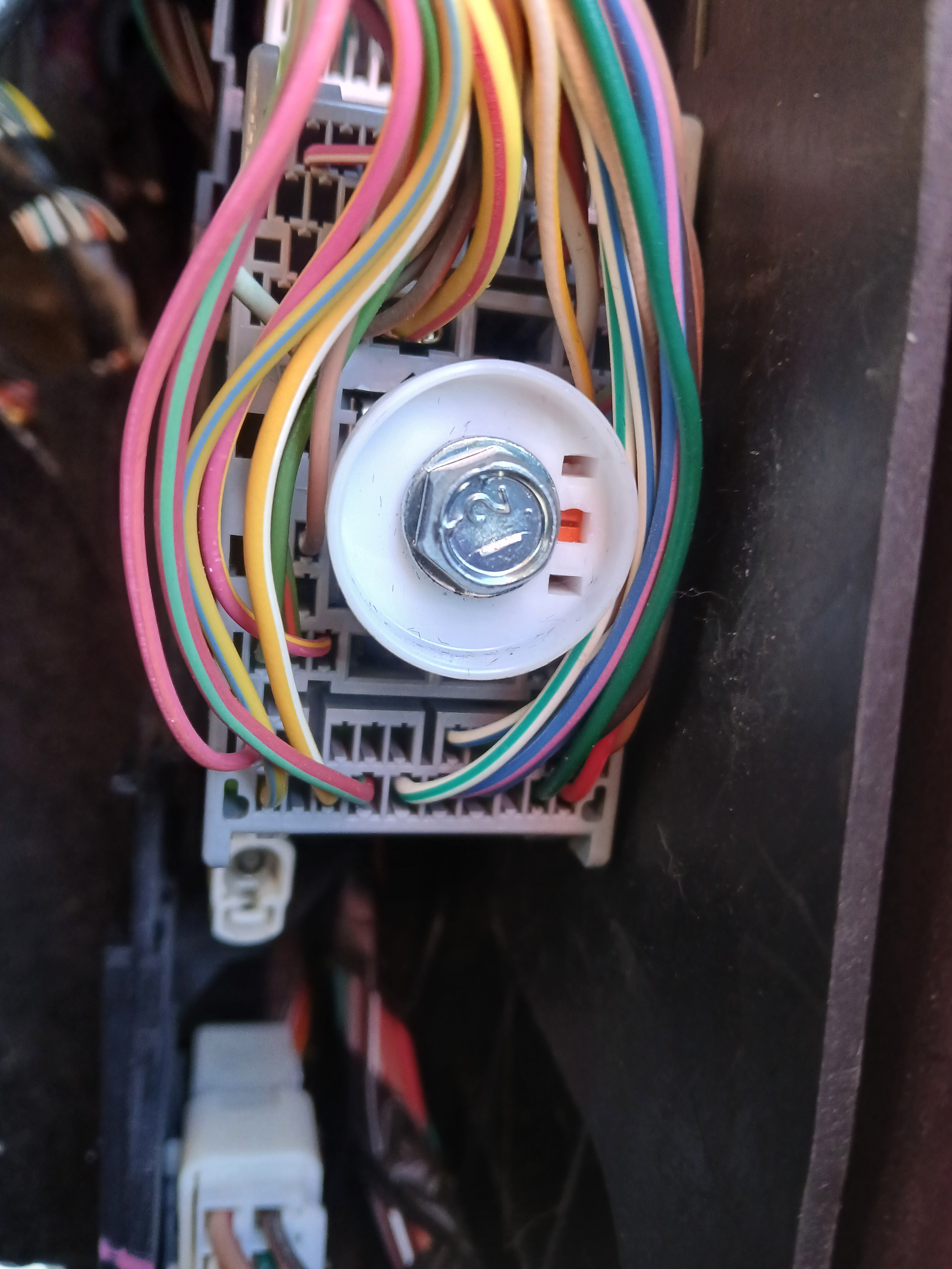

i have a 2012 jeep grand cherokee i am trying to disconnect the wiring connector and unable to take it off. i have gone to jeep dealership and they said never seen before. this connector is on passenger side firewall by blow motor. i unscrew bolt and it just spins at this point. i have looked all around box housing and cannot see clip any where. there are 2 holes right side od bolt i have incerted pins and still will not release connector. here is picture would really appreciate advice.
this forum with its expertise i am hoping can help me.

Put your finger around the white part and pull hard. That may just be for pulling on
Did that do the trick? I assume that you're supposed to loosen the bolt first, then pull on the white fingerhold.
after fiddling with it all day, i got it to come loose. this connecter has 2 tabs one on each back side on inside of connector box. you have to use a hook tool to push on sides and twist in box and pull out to release. thank you for wll you help.
Thanks for the followup. Is this a factory connector (as far as you can tell)?
