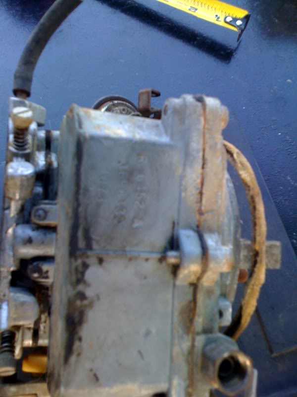

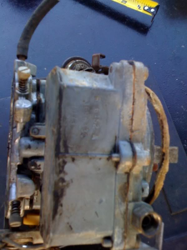

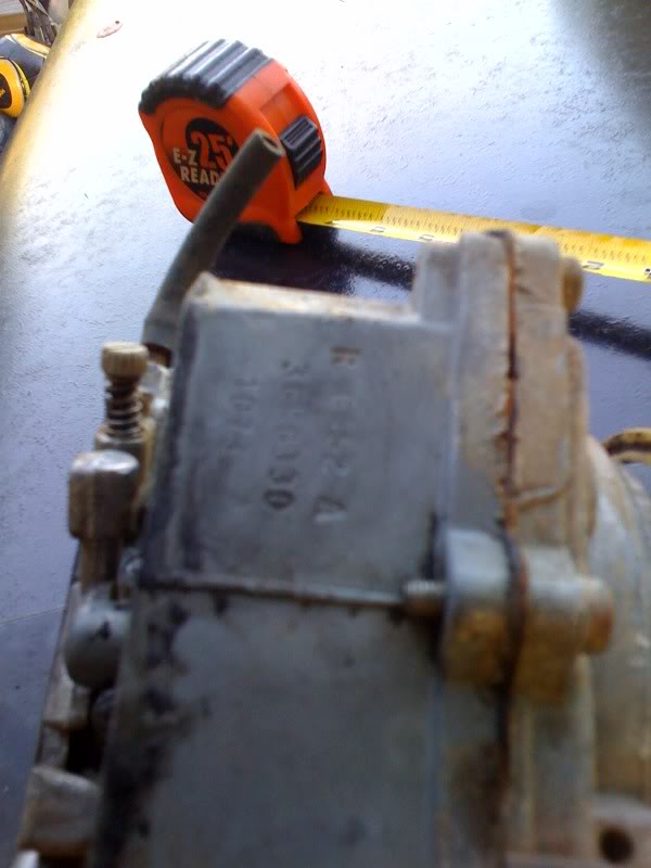

it says r6452a and was produced in oct of 73
same side to try and get the lettering easier to read
again

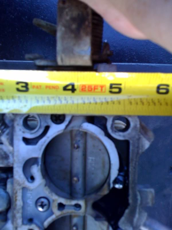

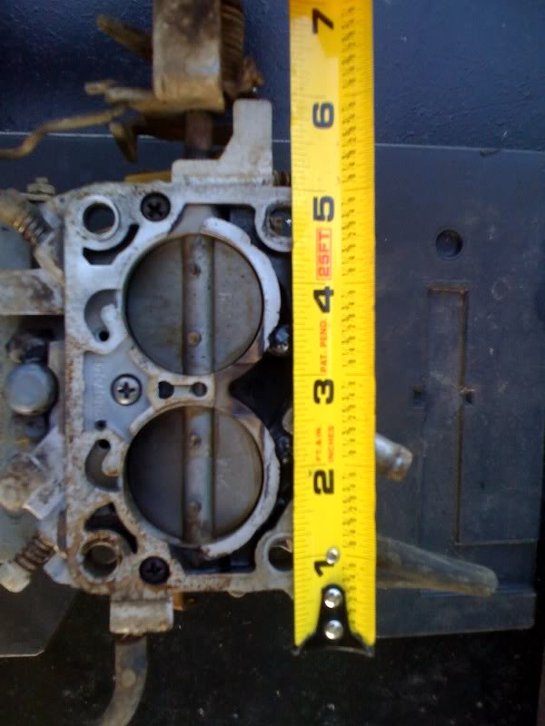

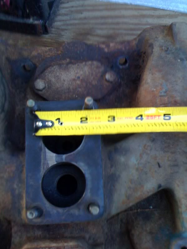

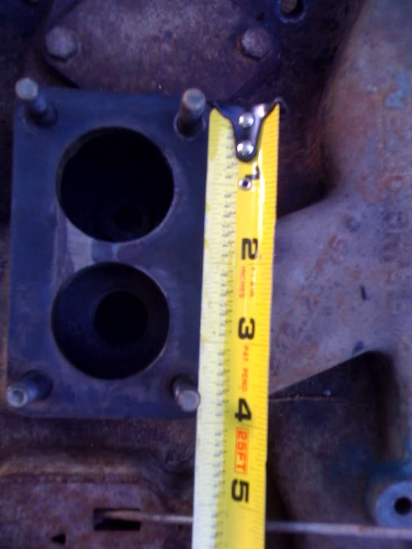

spacing
long spacing
intake bolts on the one the carb came off

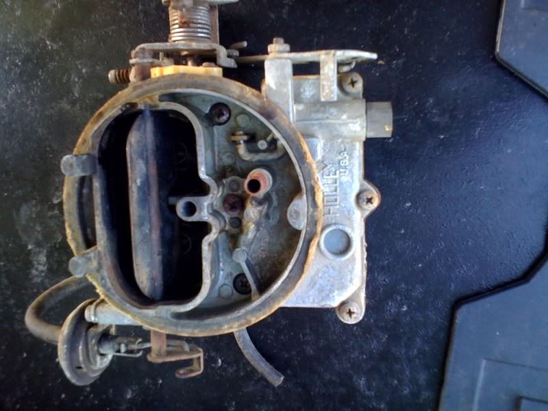

top of carb, holley is big as day on it
what do you guys think? anyone ever heard of this carb being tried on our jeeps? i hope it works because i have having all those dang spacers
no. i have looked on tons of sites googling that number and i cannot find any specs on it. i really hope it will work good but i have reservations since i cannot find anything. i don't want to be bummed out because of how lucky it is to have the same bolt pattern
ok, i found one thing on HAMB and it lists the 2210 holley carb (which is what i am lead to believe the r6452a is as 260-340 cfm. this carb was used on everything from the dodge 318 up to the dodge 400 v8s and the IH 315v8 up to whatever their large v8 is. everything says its a great carb.
i just hope all this info i am finding it right.
this carb looked like brand new on the inside. the jets are marked 661 and are huge. i am sure they are to big to run in this engine but i will put it together while i wait for a jet kit to come in and give it a shot.

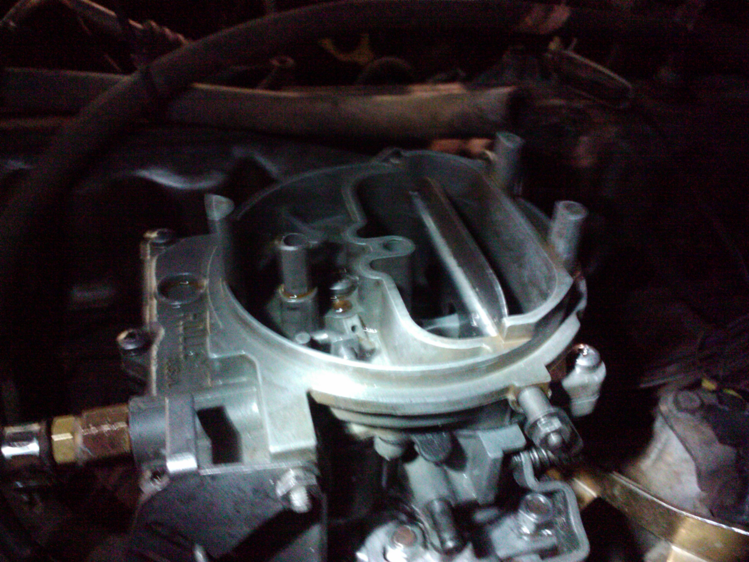

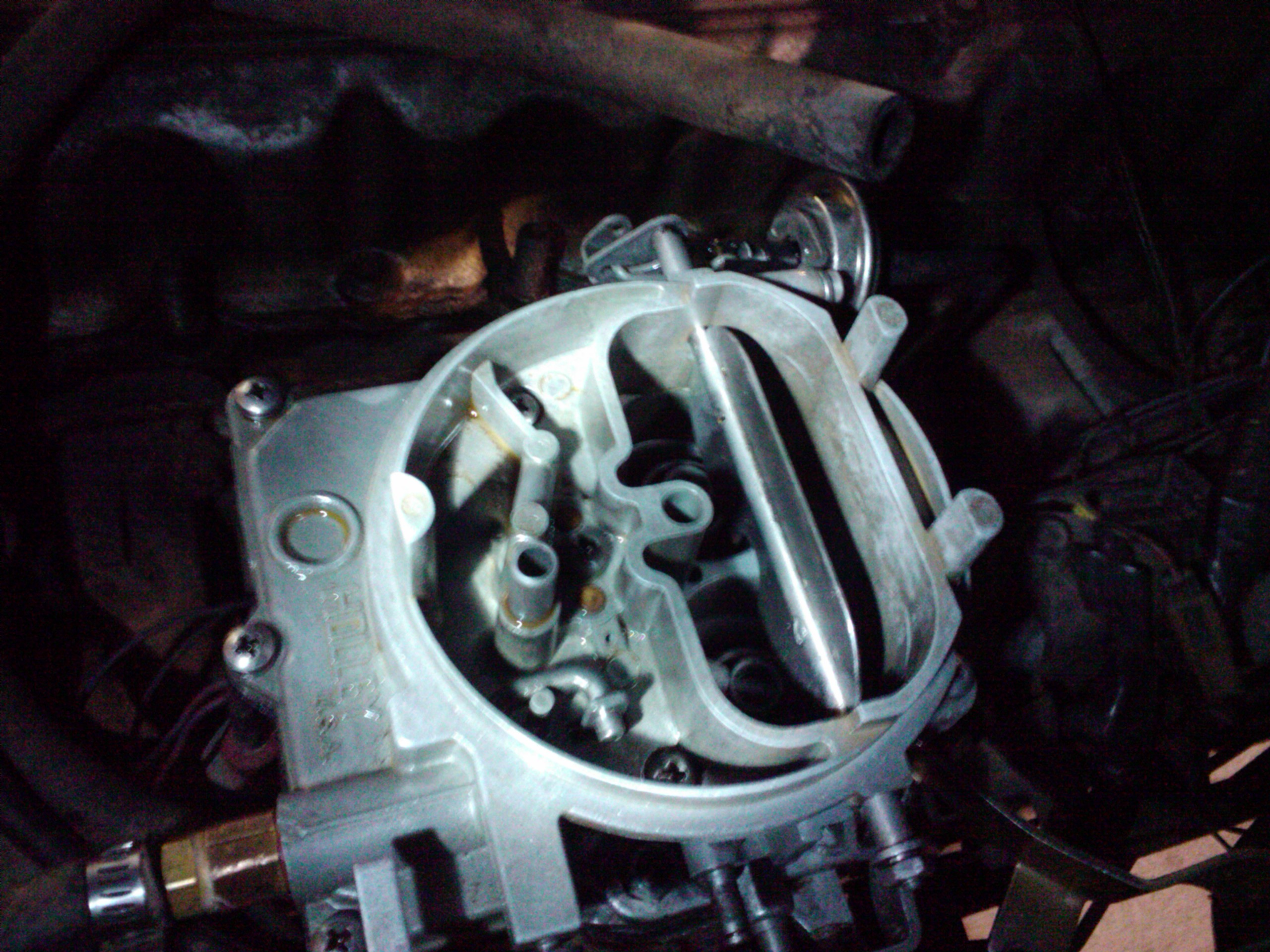

ok guys, finally installed this carb. my measurements were not as right as i thought, the holes were off by alot on each hole. at first i was kind of mad because i had already taken off every thing off and had everything all set up to install the holley. since the holes were off so horribly because i measured the weber adapter when i checked the stud measurements, i installed one of my motorcraft carbs instead. the one i wanted to put on has the little bb looking ball stuck in it so i put one a little larger on and it wasn't right, of course. so, i took it off and looking at the holley i decided screw it, i have already rebuilt and got everything set up, i am just going to get my dremel and match the holes to the studs.
it worked out beautifully!!
i installed the holley and turned the key to run so the fuel pump would prime the bowl for a few seconds and then turned the key and it fired right off. it didn't stay running though so i adjusted the jets out to 2.0 turns and the idle screw out to 1/4 turn and turned the key to start again. no-go again but it stayed running for a few seconds. so i turned the idle screw out another 1/2 a turn and fired it up again and this time it stayed running. idled dead on 500rpm. i adjusted the mixture jets in a little and turned the distributor advanced a bit and the idle moved up to 750 and has been dead rock solid ever since.
i took it for a spin to orielly's to get a filter and adapter and it has a noticeable flat spot so i imagine tomorrow i will get out the timing light and see where i am riding and then fiddle with it to get that flat spot worked out. after that, i have to figure out some way to get the kick down for the transmission to adapt to this new set up. i think i am going to use a cable instead of all the metal bars that are the stock kick down though.
i attached two photos for your enjoyment
