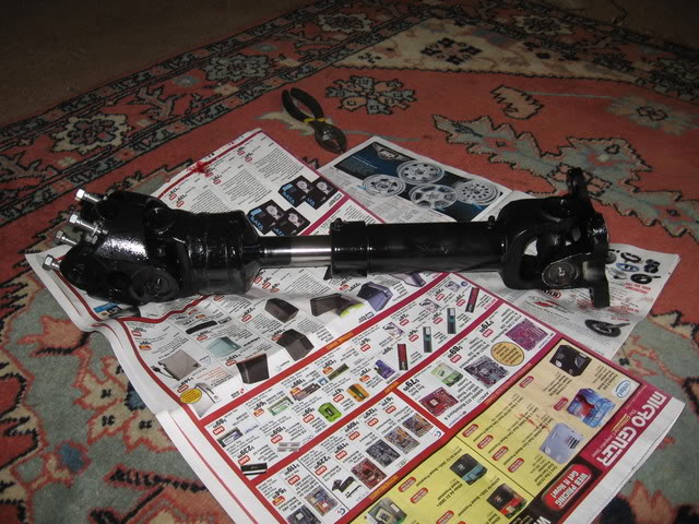

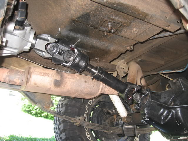

Well, we got the Jeep back together. We decided to do a major modification to the transfer case and drive train rather than just put it back together. We installed a "Slip Yoke Eliminator" and a custom "Constant Velocity" driveshaft. Doing that also allowed us to moved the back axle forward about an inch so it is centered in the fender well. With the driveshaft installed, we were also able to get the rear differential lined up almost perfectly.
		 The new driveshaft...
		 The drive shaft installed...

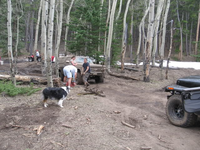

The truck was high-centered at two points. I thought we could get the Jeep behind his truck, use a tree strap and the snatch block on the passenger side front bumper hard point to pull it out level where the other tires could get traction and he could drive out.
Tom said that the weight of the vehicle would require the Jeep to be in front of the other. We could use a strap to tie the back bumper (of the Jeep) to a tree and we could use the snatchblock on the same hard point but bring the winch rope right back to the Jeep's front buffer effectively doubling the capacity of the winch. That is what we decided to do.

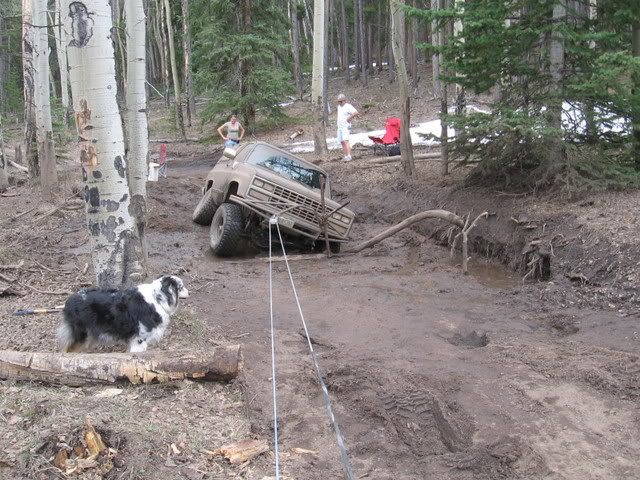

The picture above shows the process just after we started it. Now, those of you that experience back country riding know that activities like this can draw a crowd. We had a small group of people that were assisting, observing and/or just offering advice. It became an event.
It was a slow process, but we knew that we had set it up correctly. The truck slowly rose out of the water. We knew that we had broken the suction of the mud and water on the buried tires. The passenger front tire touched the ground. I thought that it would get traction and pull right out. That did not happen.
We stopped the process and looked things over again. The driver could not steer the front at all. The driver side tire appeared to be locked in place. That would make it much harder. We were sure now that he had a broken axle.
We talked about it and decided to continue the pull. Slowly the Jeep pulled the SUV completely out of the road hazard they had found. The pull was compounded by the frozen tire, but it came out.
