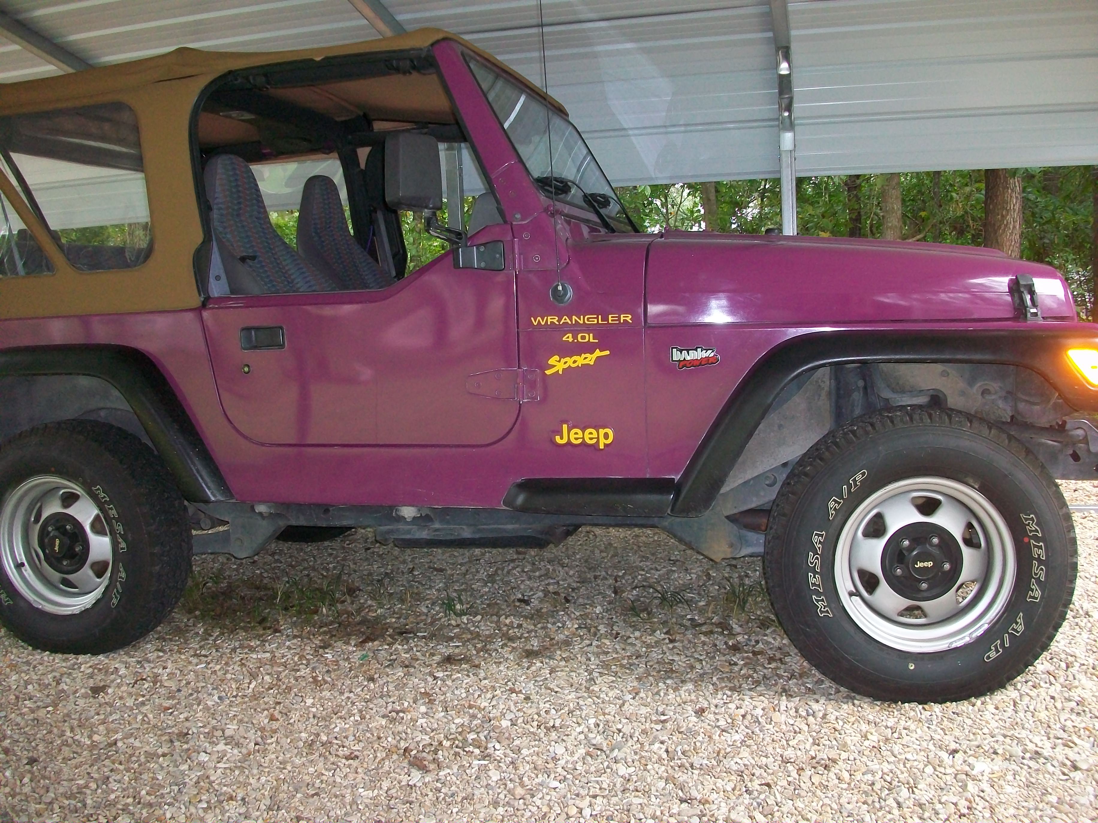

it looks lifted
ronnieb
where would i check for lift?
What year and what size tires?Looks like a TJ with stock tires.If it is there may not be on a lift.To look for the lift see what the size is of the body bushing.Easiest place to look is above the rear bumper.Should be a rubber disk about .5" think.Any thicker and it may have a body lift.Suspension lift you could look at the top of the spring mounts for spacers.if there is you have a budget Boost lift.Other then that you would have to measure the length of the coil springs to see if some one replaced them with longer ones.
couldn't get the photo to up load here. the coil is on my gallery , 97' stock .
