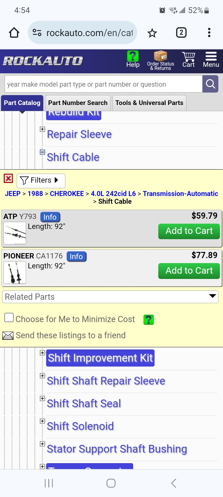

All the cables i find are 92 inches. This is from rockauto.com
There is one very long cable that appears to run almost the underage of the jeep, over the transmission toward the very back. I think what bothered me was the pictures online. I thought my end looked different to me. I will crawl under it tomorrow and follow it out and check out how to unhook it.

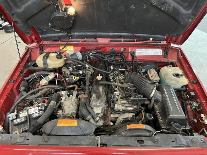

if i remember right, it goes from the throttle body across the valve cover and then curves down along the transmission bell housing to the kickdown lever.

the length won't be a problem, other than having some excess in the engine bay. it slides in the sheathing once the sheathing is attached the transmission and valve cover brackets. once you hook the cable end to the kickdown arm and push that button on the throttle body side and slide the tb arm fully open and closed so its sets the cable length, you will be good.

on your throttle body, you have two cables connected? or three? laredo should have three since its a higher trim
1st: accelerator cable from the gas pedal inside the jeep. should be short
2nd: kick down cable to the transmission. should be longer
3rd: cruise control cable. should go to a little black motor in the engine bay.
the black cable just above the yellow oil cap on hte valve cover is the one you are talking about? that should be your kick down
