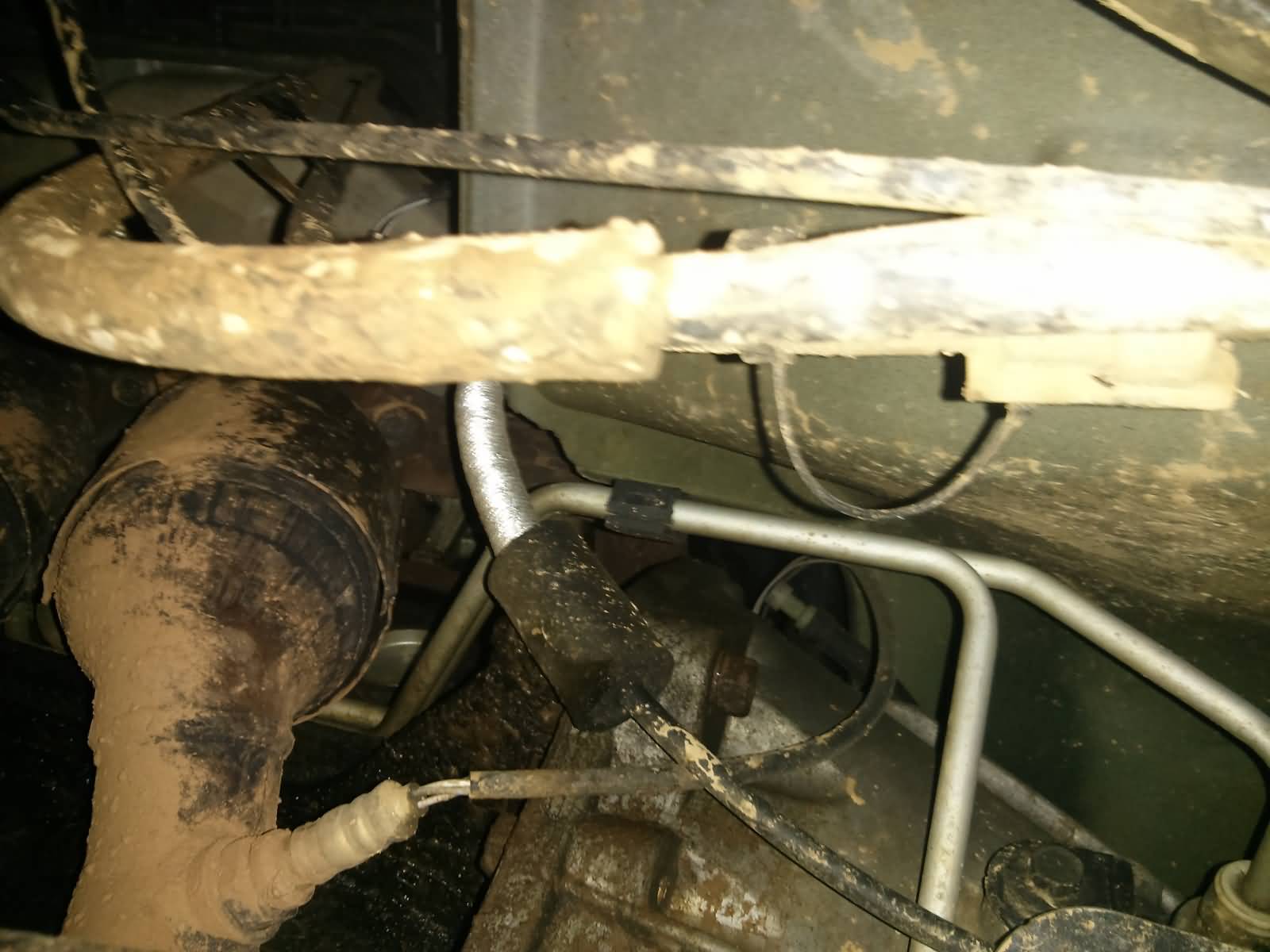

I did some offroading last weekend, and got in a bit of mud. At one point I had built up some speed (we'll call it momentum), and plowed through some of the thick stuff. The front end popped up a bit, and I came down pretty hard - at that exact time the check engine light came one.
It's been two days, and the light is still on. My code reader gives me code P0057. It appears to be an O2 Sensor, but i can't for the life of me figure out which one of the four.
I've looked around, and can't find any broken or loose connection - could the impact have broken the O2 sensor, or is it likely something else?

Could be, have the code cleared and see if it returns. If so just replace the O2.
Honestly I am more leaning toward drastic temp variables being a potential cause. On the throttle, heat soaking the O2's electrode than submerging in cool mud quickly cooling followed by another heat soaking.
I agree. If the DTC comes back, it's best to replace both upstream and downstream sensors if all of them are of the same age. One of the sensors might have received enough impact to damage the element internal to the sensors. My bet would be one or both of the downstream sensors.
