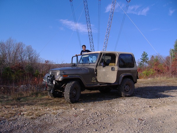

Mine has a 2.5" Rubicon Express suspension lift and 31's. It's adequate for most any type of wheeling except rocks. I intend to modify it further as time progresses but I am pleased with how well it does in it's current form:

Twisted, you've got my favorite color sahara. Do you know what years that color was available?

91 was the only year with the fuel-injected 4.0L and the last year for that color. I believe they can be found in 89-90 years with the 4.2L carbuerated engine.
I searched a good while for this year/trim package. I've wanted one for years.
