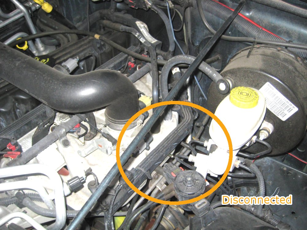

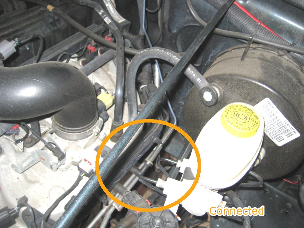

Wrangler Defroster problem fixed
OK, so I"ve fixed my defroster problem. It turns out that the air selectors in Wranglers are powered by engine vacum, and one of my tubes had popped off. I've found it, reconnected, and everything works.
Now I have a new problem. I drive on the highway, then pull to a stoplight and my engine idle jumps between 600 and 1200rpm. Ususally it is just once, but sometimes it just sits and surges, causing the Jeep to buck. It has been doing this for about 3 days now, since I fixed the defroster. The computer is not throwing any codes.

Just an update - it appears that the computer just needed time to process everything. It's been almost a week, and the problem has pretty much gone away.
