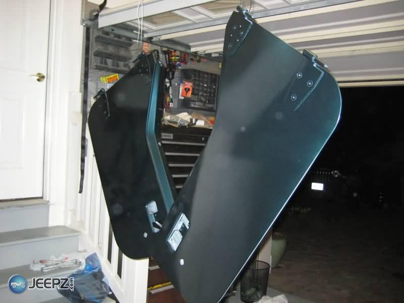

I've painted my previous Jeep a couple of times, and more receintly I've painted my hard doors, and I can say that it's all about the prep work. You have to make sure that you have no rust at all, or your paint job will bubble up in a year. Take off anything that you don't want painted, including the flares (It's better to take everything off than to tape it). Be careful with the amount of paint that you put down - I had a beautiful set of half doors, but wanted to put just one more coat on, I stayed in one spot too long and now have a drip mark next to my key hole.
If you paint it in your garage, cover everything with plastic and hose the floor down with water. Leave the garage door half open with fans blowing the fumes out. Be sure to wear a good mask because the fumes will make you light headed quickly.
Just take time and get everything perfect before you pick up the gun. I like to hang stuff with wire coat hangers and spray them.
