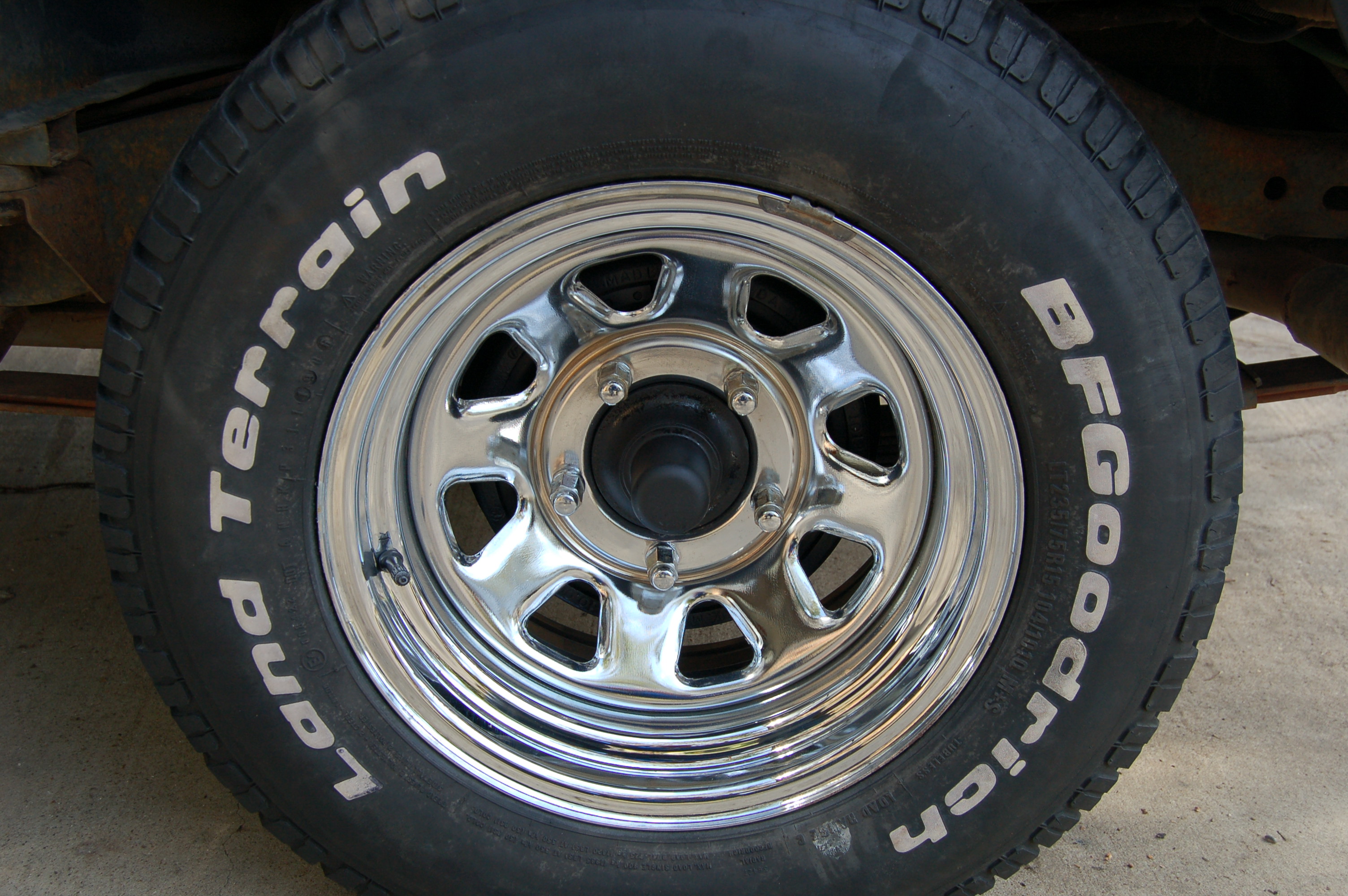

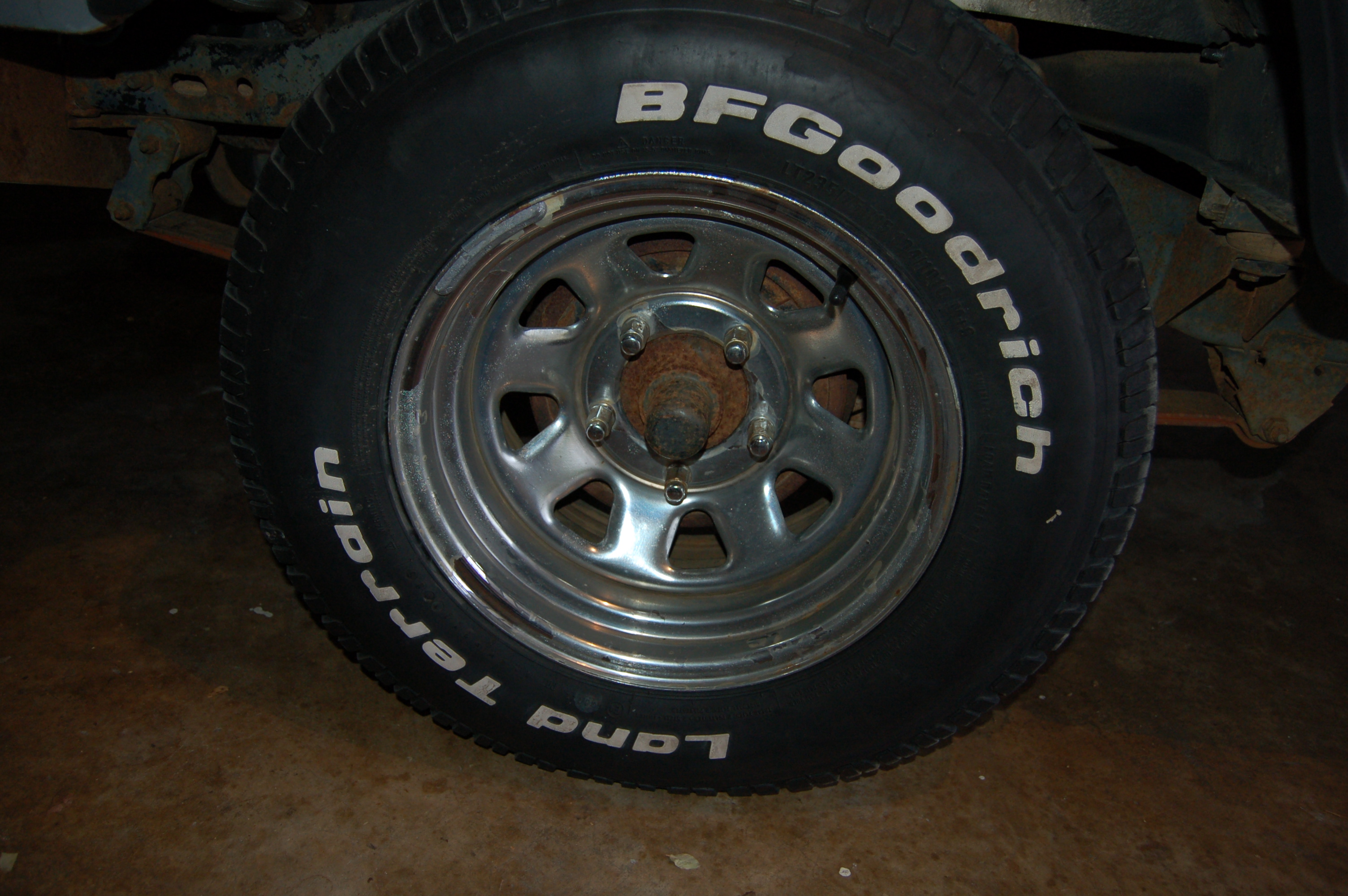

Here are before & after pics of my wheels. I used spray on "Stripper" manufactured by Klean Strip and purchased at Home Depot for approx. $7/can. Had tried "Aircraft Stripper" and it took 2.5 hours to do one side of one wheel. I did all 4 other wheels plus the back side of the first wheel in hours total using the aerosol Stripper. Sprayed it on, waited about 10 minutes and the lacquer was almost falling off the wheel. Very little elbow grease required!
