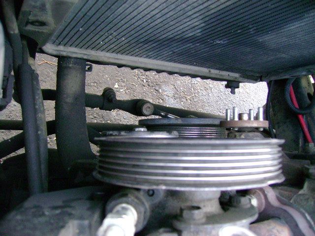

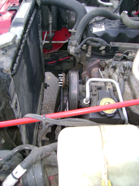

OK here are some pictures from my engine bay (fan shroud, fan and water pump pulley removed for clarity and I know the radiator needs replacement). As you can see the harmonic balancer / crank pulley is positioned much farther forward than any of the pulleys (about 1/2 an inch). Can this part work itself loose over time? And yes it does have a manual tensioner. The water pump shaft has zero play in it all off the pulleys are square and rotate freely. This is a 4.0 engine.

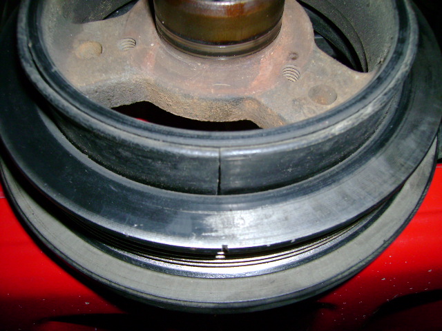

looks like a problem i had w/my old 91 - check the harmonic balancer pulley (crank) - looks like its seperating (its a 2 pc. unit w/dampening material b/w the pulley and hub...)if its sticking out too far its probably the culprit.... - mine was just enuff to jump 1 groove and start shredding the belt... pictures speak a thousand words eh? that looks like the problem... g'luck and let us know..
I agree with Bob. the pulley to Damper bushing is worn out and slipped off enough to throw the belt off.

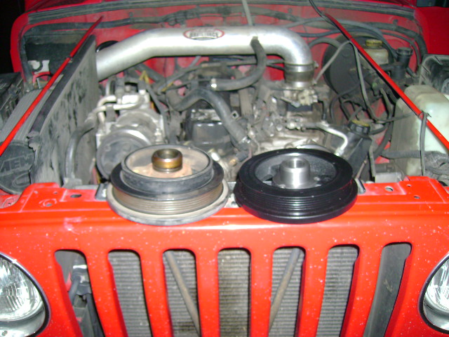

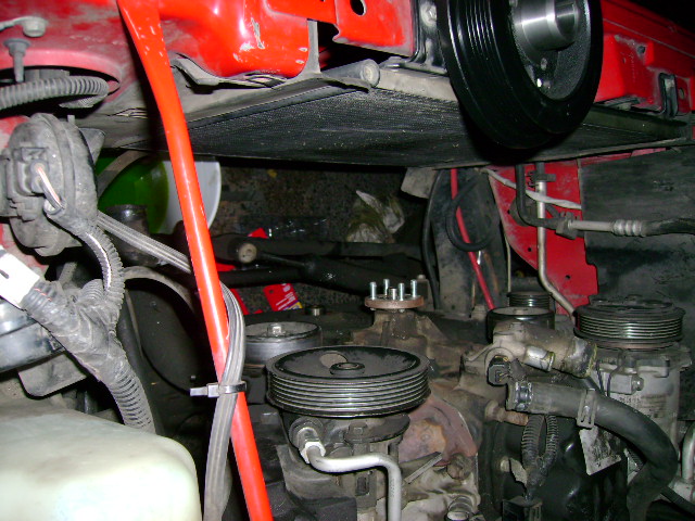

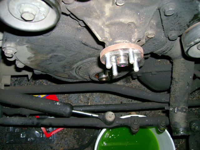

Yup, you guys nailed it (thanks). And here some pics, I'm going to install the new one tomorrow.
