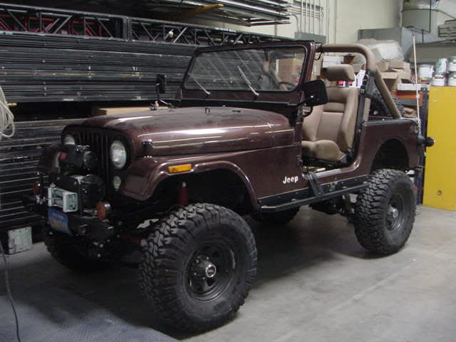

I ended up going bigger. I decides to go with the rubicon express 4.5 extreme duty lift. I am very happy with it, it gave me enough room to clear 35's! Even without my body lift 35's would fit easy. Once these tires are gone I will scoot up to 35's. It handles about as good as the rancho but the ride is alot better and it travels alot more offroad. THe most I have messured is 19 inches of travel in the front, and like 14 in the rear. All 4 wheels stay on the ground too which is totally sick! Lets just say I havent had it stuffed the tires yet!
(rubicon express 4.5, 1 inch body lift and 33's)
