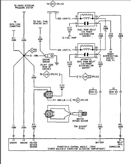

This morning the Jeep won't start. The fuel pressure gauge reads 0 and does not increase for any reason. I have never heard the fuel pump start up so I am not sure if it's coming on or not. I think I need a new fuel pump and/or check valve.
things to check - fuse, relay, ign sw - then is 12v at pump
REMEMBER if not running pump oly has 12v for @2seconds-
