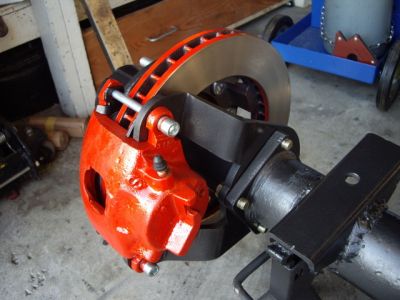

These are for those of you that want the strength of a 14 Bolt Axle but don't want the width of a Single Rear Wheel (SRW) axle. They are the same axle with different hubs and a different offset is required for the disc brake setup. And you definately want to do this swap, the factory drum setup on a Cab & Chassis (C&C) axle weigh most of 100lbs per side!
