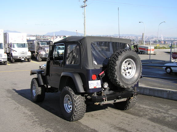

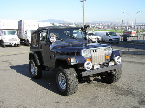

I put 6" extended TJ flares on my YJ after I got a vehcile inspection. These ones are made by Zenon but fit the same as stock TJ flares. I did it without cutting the sheetmetal and just painted the wheel wells under the flares with black undercoating. I'll be cutting the sheetmetal sometime next summer when I get time. Plenty of clearance with my 33's although they still rub when I stuff the tire. Here's a couple of pics of what it looks like... http://www.cardomain.com/ride/475506/9

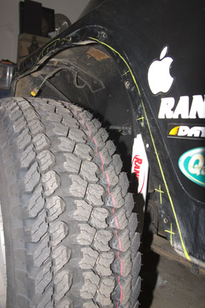

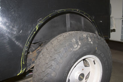

I put TJ flares on my YJ about a year ago and love the look. You won't need to cut any sheet metal to mount them if you aren't already rubbing. I trimmed mine becuase it just looks cleaner and was a fun project. The only problem I ran into was marking to drill the mounting holes. The stock holes from the YJ don't line up and there isn't a lot of room in the flares to get a good marking. So I borrowed a right angle drill from a buddy and used self taping screws to mount them. After they where on I just picked up some new side markers. I will attach some pics of my cutting lines and any other shots that I can find.
