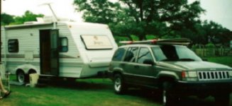

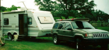

we pull a 6800 pound trailer with ours , and it can do a little more.it pulls that trailer as good as our 1 ton truck acctully a little better than it. you might want to go to a trailer dealer ship and ask them. they will tell you exactally what is the limit.

heres a pic

Looking at that pic with the camper-trailer, that ZJ 95 posted, you should have no problem... I know that my XJ weighs just under 4,000 pounds, that trailer is a lot more than that, and I am pretty sure that the Mazda weighs less than an XJ, so you should be fine :)
