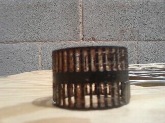

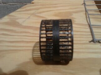

i just found out i have a stinkin ba10 transmission on my 88yj an my first gear broke so i got a new one but i am having ALOT of trouble finding the first gear needle bearing:x any suggestions besides getting rid of dat ba10? LOL:lol:

No idea man, unless you have a bearing shop nearby and take them the old one. They can match it up with a timkin or something exactly
Looks like the same type bearings that are in a Harley 5speed trans. I got some for my bike thru Motion Industries.

Take the bearing number to a bearing shop. They will match it up and give you one. We have two bearing places here in town an they will measure the bearing in a bunch of spots and run the numbers on the computer and give you a list of same size replacement bearings

Well the bearing doesnt have a item number or any part number at all they told me dat it would be a part from OEM...? An i went to o oem website an still cant find the frekin part! Im located in fort stockton tx.. near el paso,midland/odessa tx
Not something you will have luck finding on the web. Have to go down to a bearing shop and match it up. There's a bazzilion sizes of bearings like that in use. Almost all today's manuals use em. You will find one from another application or a cross reference book. That will be the same.
I already did an da only kind they have r da singe needle ones dey dont have double needle caged like mine an dey said dey dont make does kind:( dat wen dey told me to go to a jeep dealer to see if dey had it an dey told me da same shit
Strange. I was at a driveline shop on Friday. They had a whole bin of assorted double caged rollers. There was probably a thousand diff sizes.
