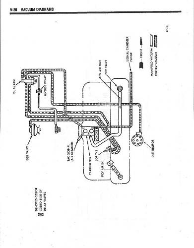

Where can I find the diagram for the vacuum lines on my cj has the inline 6.
Some haynes/chilton repair books may have a diagram included. Or you can always try to call the dealer and ask them for help they may know or can point you in the right direction
Try this drawing. It's not for 1982 but should be close.
