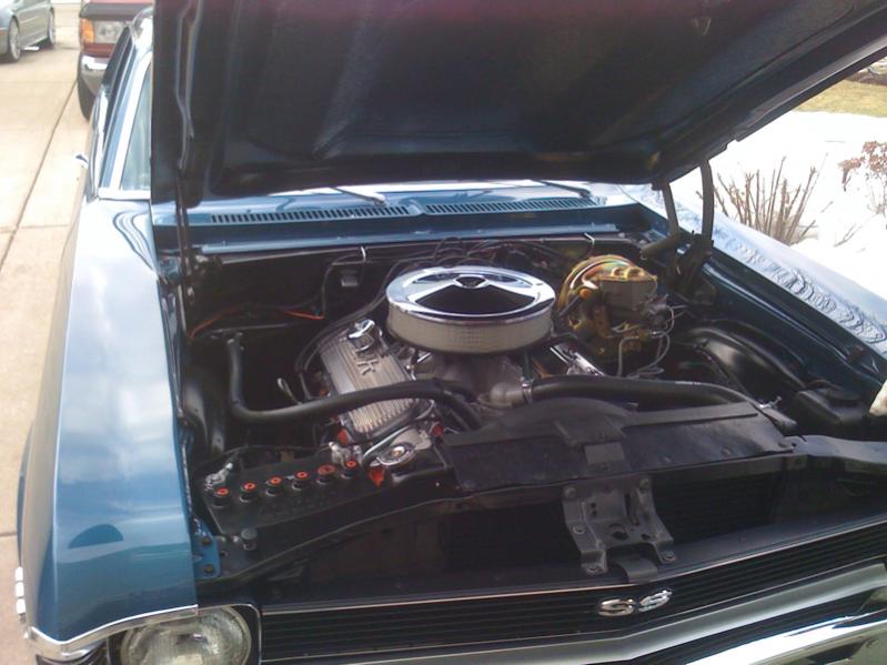

I run a Holley 4 barrel double pump on my 79 150 it has a 428 cobra jet. I also use a holley 750 in my 70 nova SS W/a 454 and with a 10.3 1/4 time. I would have to say they run pretty good.
Hows that Holly look?

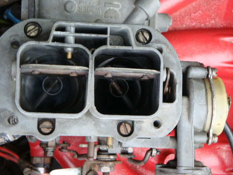

you think the choke is bad or is it just out of adjustment? tomorrow morning, open the hood and pop the top of the air cleaner off and make sure the top plates are closed all the way. yours are square, right? they should be fully closed on a cold engine.
this should not be how your carb is on a cold day. this is fully open chokes. see the plastic thing on the right side of the carb, in the pic. it has a ring around itwith three screws, roughly 120* apart? that is the adjustment for your choke plates. if you pop the hood and those plates are any near open, loosen the three screws around that plastic thing and twist the plastic thing until you close the choke plates. close the but don't go past where they close too much or they will not open all the way when they are warm. once you close them, tighten the screws back up and see if your jeep starts up.

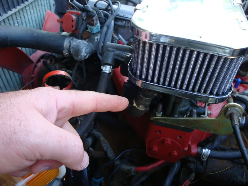

to tighten the leak between the adapter plates, remove the nuts at the base of the carb
you will probably have to unhook the throttle cable and some vacuum lines so make sure and mark them or put it back together fairly quickly so you remember where they go. either way, under the carb, if you have two plates stacked on top of each other, there should be a gasket between the two that might need some rtv or need replacing. the one under the bottom plate might need rtv or replacing also, same as the one on the bottom of the carb but no rtv on that one. stuff comes loose after a bit so its good to check those if you think you have a leak there.
you're heading the right direction to get it running right, so keep going and asking questions for whatever you need. (all those carb pics are from my weber 32/36 on the ol' 1.8 litre bmw engine in my 81 bmw 320i i used to have)
