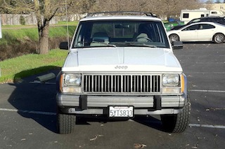

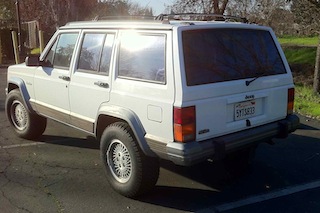

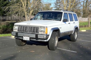

And the last couple of days were sunny so I got some "before" pics (low bandwidth) so you can what I'm starting with.

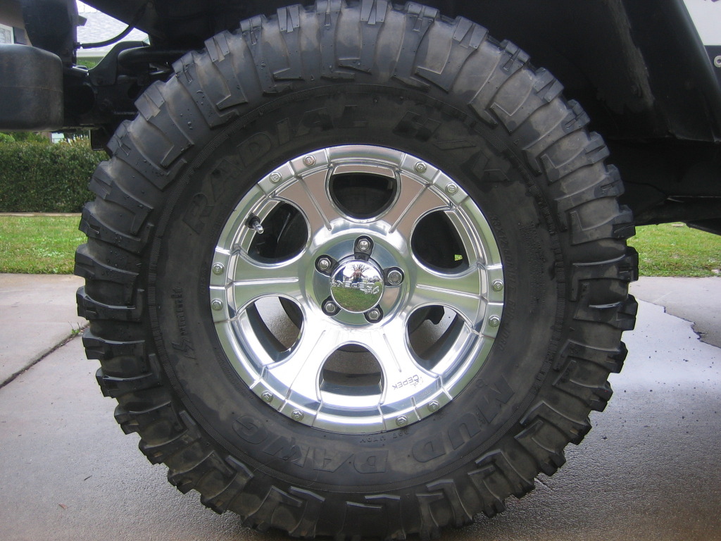

Already been another change ... a friend came across a set of 5 Dick Cepek DC-1 wheels with Mud Dawg 33x12/15 tires mounted on 4 of them. The tires have about 50% tread. Both wheels and tires look like most of their lives have been spend on-road and look perfect. The whole lot for $450. I'm picking them up tomorrow. As I was told earlier today, "eBay is your friend".
Picked up the wheels and tires today ...

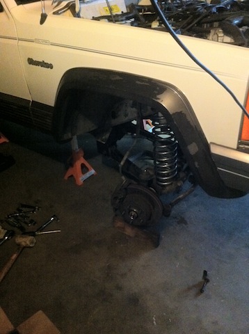

Let me first apologize for not having any pictures to show of today's work. Steve and I got started this morning and didn't really take any breaks. Got the Cherokee up on jack stands and wheels pulled off then took a look at what we wanted to attack to start things off … we decided on the front.
So, at the end of the day here's what we had accomplished:
1 - Removed shocks and front coil springs.
2 - Disconnected brake line brackets.
3 - Disconnected track bar at axle.
4 - Installed the control arm drop brackets.
5 - Got ahold of a spring compressor to get the 4.5" coil springs installed along with with a 2nd factory isolator.
6 - Everything is all bolted up and ready to be torqued tomorrow night.
Tuesday, on to the rear suspension.

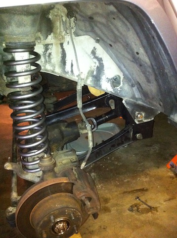

Here are a few pics I snapped at lunch today with my iPhone. A quick review ...
1 - We did let the axle sag as far as possible on each side after everything was installed. Brake lines are juuuuuuust long enough. That said, when I put on the new booster or master cylinder (standard with 33s is not going to stop very quick) the brake lines will be replace.
2 - I need taller jack stands for the future projects.

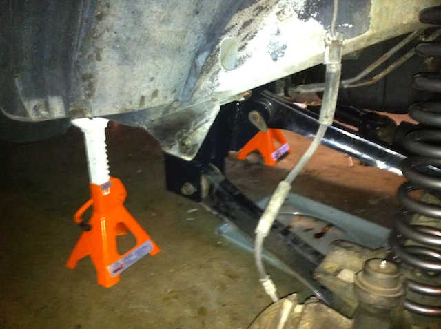

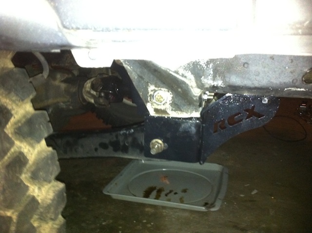

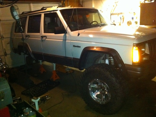

Weekend was productive but the same cannot be said for Monday night.
1 - Torque wrench rented from O'Reilly's was no good. Going back today.
2 - Had to undo some work as 2 bolts were to have been placed on each side before UCA was installed. Not as bad as it sounds.
3 - Had to loosen more work as certain items weren't lining up properly. Lost 17mm socket down the hollow frame on driver's side while loosening what used to be UCA bolt. Last heard rolling toward front spring mount ... bye, bye!
4 - While drilling 1st of four 11/32" holes for self-tapping screws the drill bit "exploded" sending shrapnel in every direction. Score "1" for eye protection!! Oh, and a replacement will get picked up today as well.
I did clean up a bit and get those 4 bolts inserted so the evening was not a total loss (small comfort). Ahhh, well, back at it tonight.
Here are the results of last night's work. Only have the front brake lines to secure and track bar to relocate. Those will wait until after the rear gets done.
I will need to weld the reinforcement brackets for the CA drop brackets as the self-tapping screw pulled through on one of the four.
Getting more of a feel for how the lift and tire combo will look when finished.

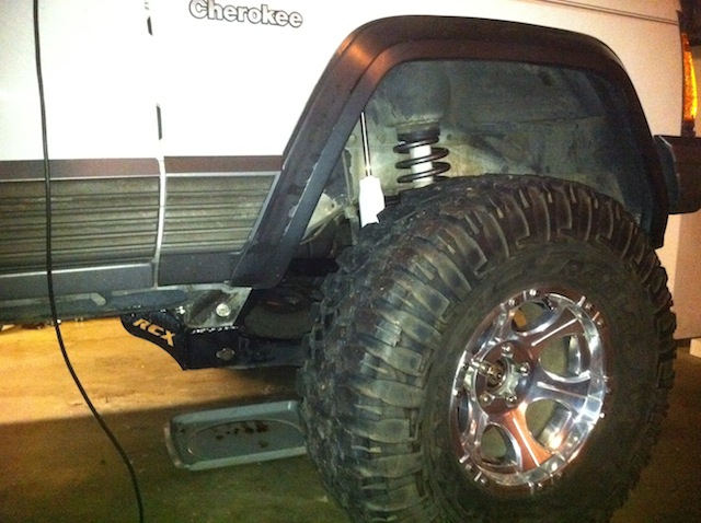

UPDATE: Did get started on the rear end Wednesday night and, after pulling everything apart, we looked at all the work to be done to make the new spring pack ... uhhhh, not so much. So my son and I went to RE and picked up new 4-1/2" springs, u-bolts and 6* shims Thursday morning. Then last night we finished the rear suspension and got the tires/wheels on. Cherokee looks GOOD!
It was too late to get pics so after I get the track bar relocated today I'll drive over to the same parking lot where the "before" photos were taken and post up the side-by-side pics.
That will leave the SYE, relocating the brake lines, extending the E-brake cables and welding the CADB reinforcement. I'm thinking maybe I'll be done with all but the welding by Super Bowl. WOOHOO!

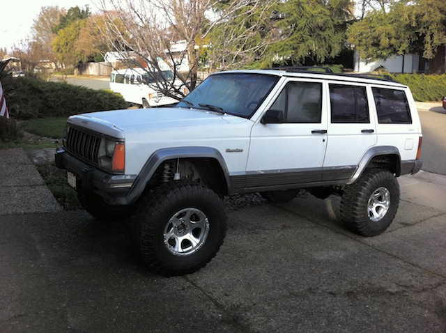

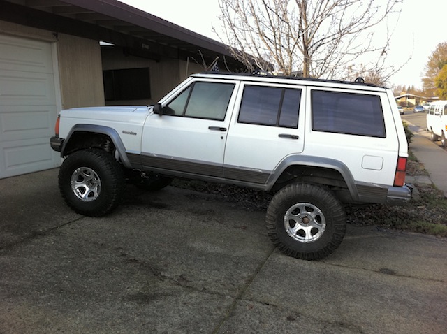

OK, I couldn't wait so here are a couple of pics taken in my driveway with my iPhone.

Most everything is in place and ready for final FINAL measure, tweak, adjust and relocate. So here is the plan for today …
1 - Ronie, my wife, went out and helped me get the measurements necessary to center the front axle (thanks, GoJeep). Without going into all the math … and trust me, I can go on and on about numbers … the track bar needs to be relocated 15/16" toward the driver's side to center the axle.
2 - Then we GO ON A DRIVE! Realizing I've not yet done the SYE, speeds will be kept down but we just GOTTA take it out and see how it all feels. Of course, the parking lot "poser shots" will get done at the same time. Those will be uploaded later today.
3 - While out and about, I'll pick up the strapping necessary to relocate the front and rear brake lines. Will get some pics of the fab and install process (Ronie will do camera … clean hands) then post those as well.
I think I will take a couple of days off before starting on the SYE. All that grinding and all. Plus, got a garage to clean up and parts to sell/swap.

Yesterday didn't quite work out the way I planned. Got the track bar relocated then pulled out of the garage for a quick drive ... NO WAY!! Pinion angle was set up for the new SYE/DS set up and was binding and squeaking.
So back into the garage to do the SYE and then ... the power went off. Ah, well, it is time for margaritas somewhere so I build some. After a couple of them the power came back on and, as wisdom comes with age, I opted NOT to work with power tools under a vehicle. Today, back at it and using the cutting wheel and a hacksaw, the SYE and DS are now installed.
How does it drive ... BETTER than with the worn out OEM springs and suspension!! As I have not yet put the sway bar back on there was a little lean but not as much as stock without the swaybar. I am REALLY happy with the way it turned out. All that research and question asking paid off.
Made a pass or 2 around the block to make sure all was good, then out onto the boulevard and, finally, out to the freeway. Probably 20 miles in all and I couldn't be happier with the way it turned out. My wife, Ronie, even commented on how smooth and stable it felt from her seat. Trust me, she is not one to sugar-coat so if I was looking through rose-colored glasses, she'd have said something.
