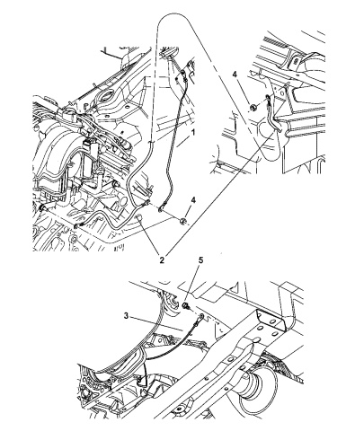

Hello and thanks for your assistance in advance. I have a 08 GC 4.7L and I see the exhaust ground strap is missing. I see where the one end goes but not the other two. Does any one have any diagrams?

Thanks for this. It helps. Not sure where the end loop is actually going but have a general idea. Your time is appreciated.
Thanks
Chris
In general it looks like: from the exhaust to chassis above the crossmember and to the engine maybe on or below the intake.
I found it on a Mopar parts site googling 2008 Grand Cherokee exhaust ground diagram.

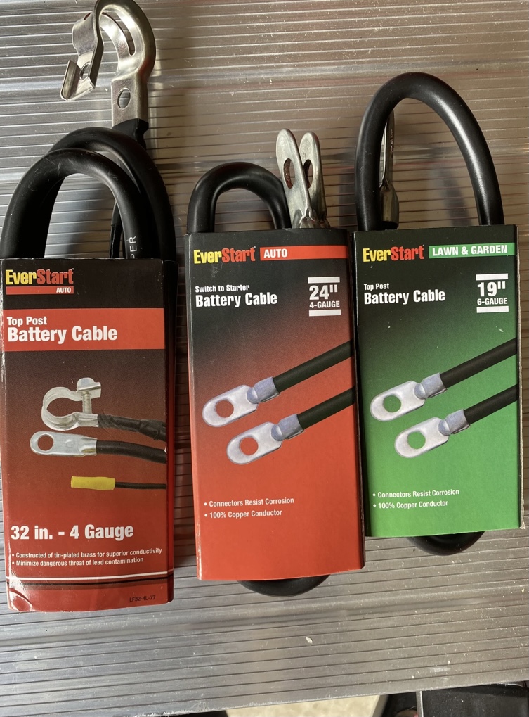

18908CAB-7F6E-40DF-8F57-2204166A22F8.jpegI’ve replaced a few ground straps for my vehicles with very cost-effective inexpensive 4 or 6 gauge wires sold at Walmart. Check them out as they are well made, universal and perform as well as OEM.
