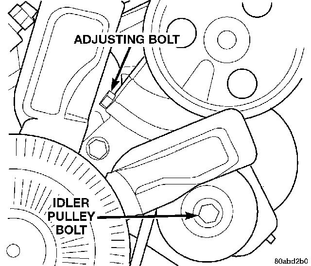

I need help installing a new drive/ serpentine belt on my 92 Jeep Wrangler Laredo w/ AC. I am not sure where the tensioner pulley is located or how to get to it. I believe that it is on the power steering pump, but I am not sure how to work it. Can anyone help? A diagram would be very helpful.

Tensioner pulley may be right below the power steering pulley. Loosen the 15mm bolt that attaches the pulley and then adjust belt tension with the long through bolt up near the pump.
