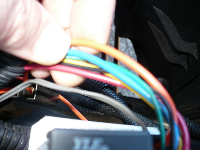

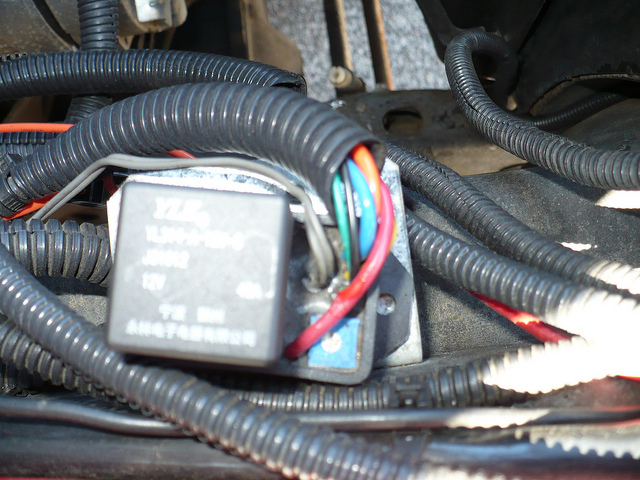

The electric fan off a 02 GC is what i'm using on mine with an adjustable thermostat switch from Napa auto parts.
Is this
