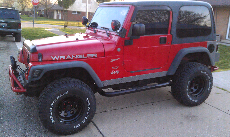

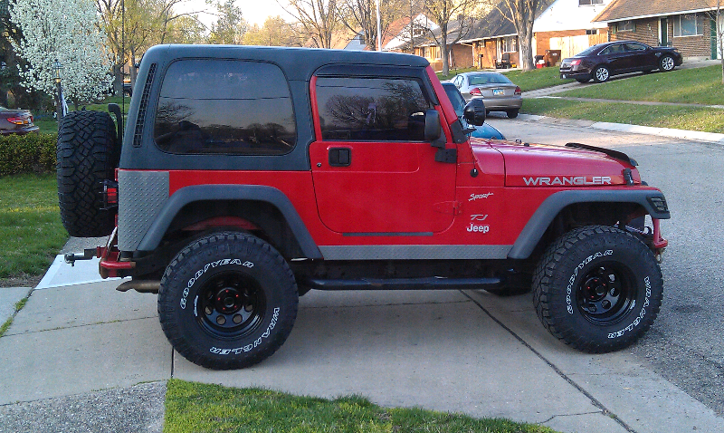

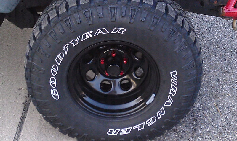

All done. There is a break-in period of sorts with this powder. Takes a few miles to fully break open the bags and get the powder doing its thing. Very wobbly when I left the shop but calmed down by the time I got home. Only a slight wobble left coming from the left front around 42 mph. Other than that it seems to bo smooth. Haven't gone above 60 yet, though.
