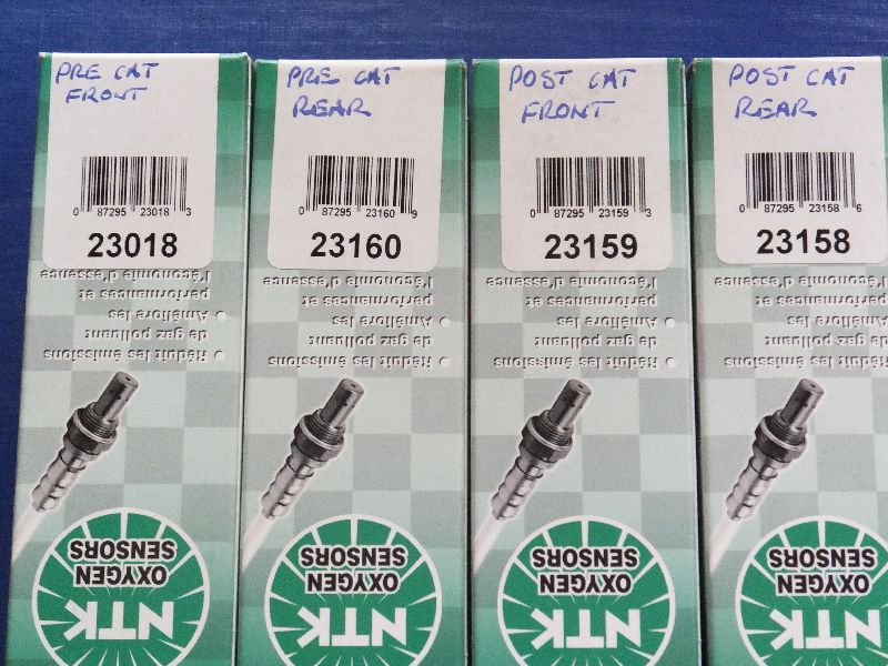

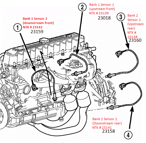

Ok so I bought my 05 a month ago had a p0153 code I believe and changed the sensor. Cured that problem then a couple days later got a 2098-2096. Changed gas stations and was left with 2098. Replaced remaining 3 o2 sensors two days ago all codes gone, now today I have a p0133. I bought all new ntk sensors from rockauto. I've attached a photo please tell me I put them all in the right spot. I also have a bluetooth OBD scanner that connects to my phone. In the readiness tests I complete all but the O2 heater test. Says "Not ready" or something like that. After hours reading on the forums I saw there was a TSB 25-001-07. Rewiring the PDC. I've read you can do this with butt connectors. Does this sound like it will cure my issues? I suppose if I'm getting the not ready message I should attempt this. Also where is the PCD? Is it the black box on the firewall in front of the passenger side with the 3 connectors? Thanks for any help.
