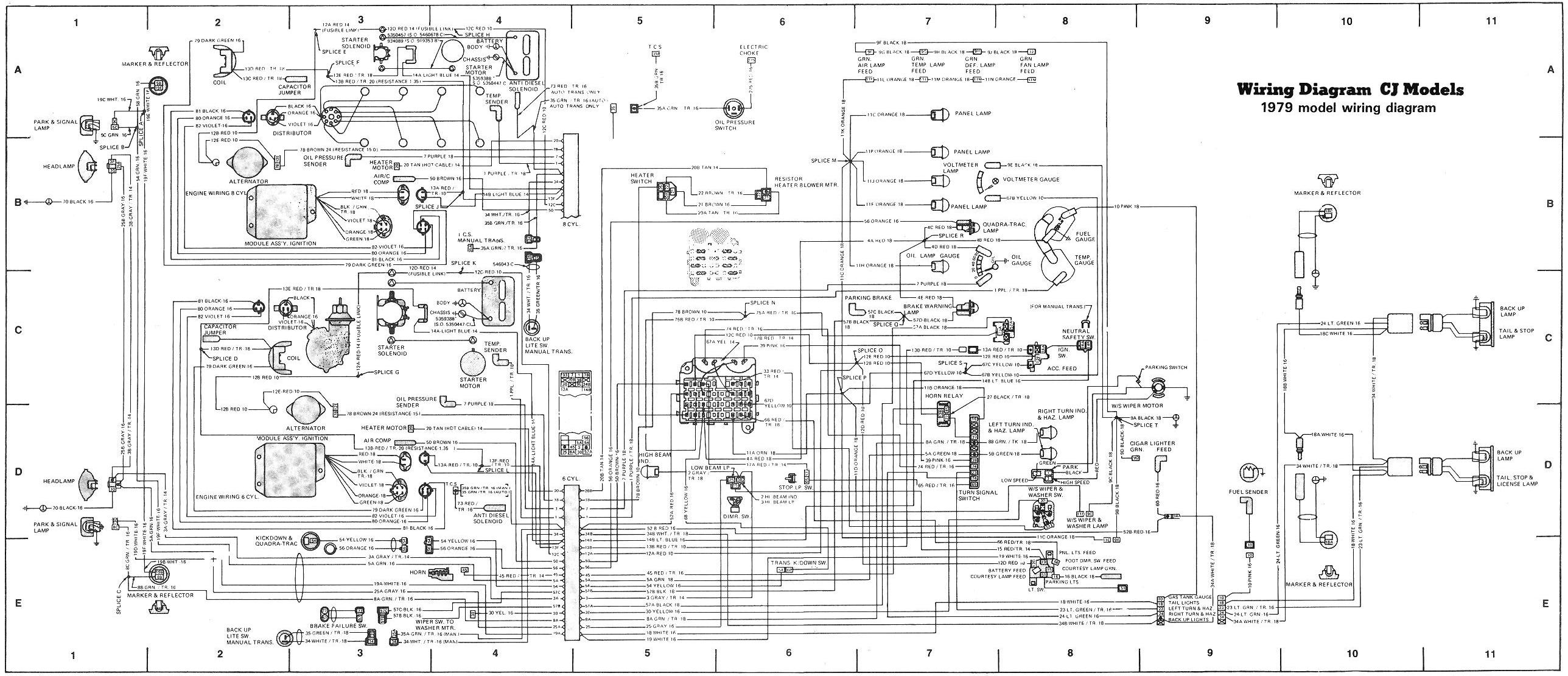

M monroe263 New member May 25, 2009 #1 Does anyone know the headlight wiring colors for a cj. The high beams, low beams, and ground. Thanks

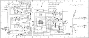

SteelHeadz Super Moderator May 25, 2009 #3 Try this diagram as well. Attachments CJ-Wiring-Diagram-1979.jpg 496.4 KB · Views: 21,664
