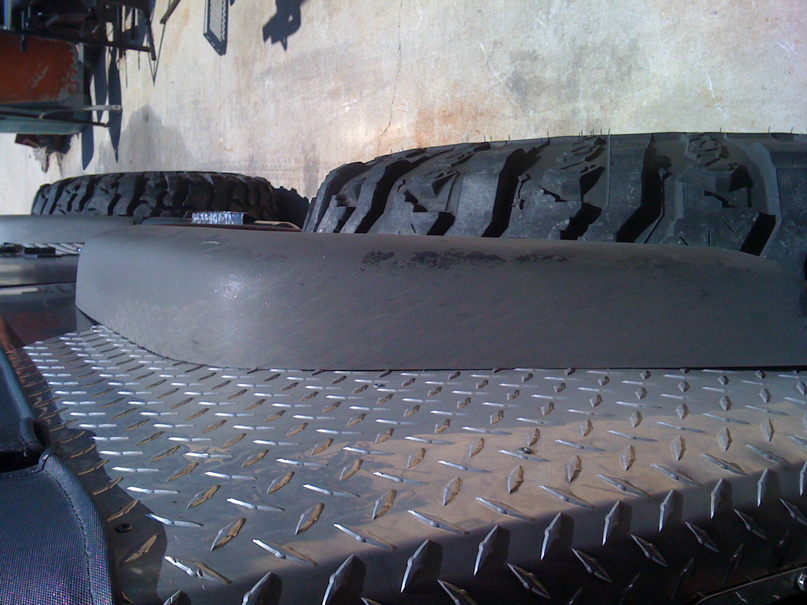

Here comes the problem. My father in law was behind me and noticed that the rear tire on the passenger side sticks out farther from the body than the drivers side. Yep I checked it and it is about 1.5 inches farther from the frame than the drivers side. And the same amount from the fender flares.
I changed out the 3/8" leaf spring centering pin. As the old ones needed it. No Luck. It might be even worse now?????
Taking a straight edge I lined up the rear to the front. The passenger side rear is out about 1-3/4" from the front. The drivers side rear is around 1-3/4" inside the front tire. The drivers side tire has about 2.5" between it and the flare. The passenger side has around 4".
It rides fine. Well at least I thought it did before this was pointed out to me. Now I think it pulls and I can't help but notice the wheels sticking out or in depending on the side.

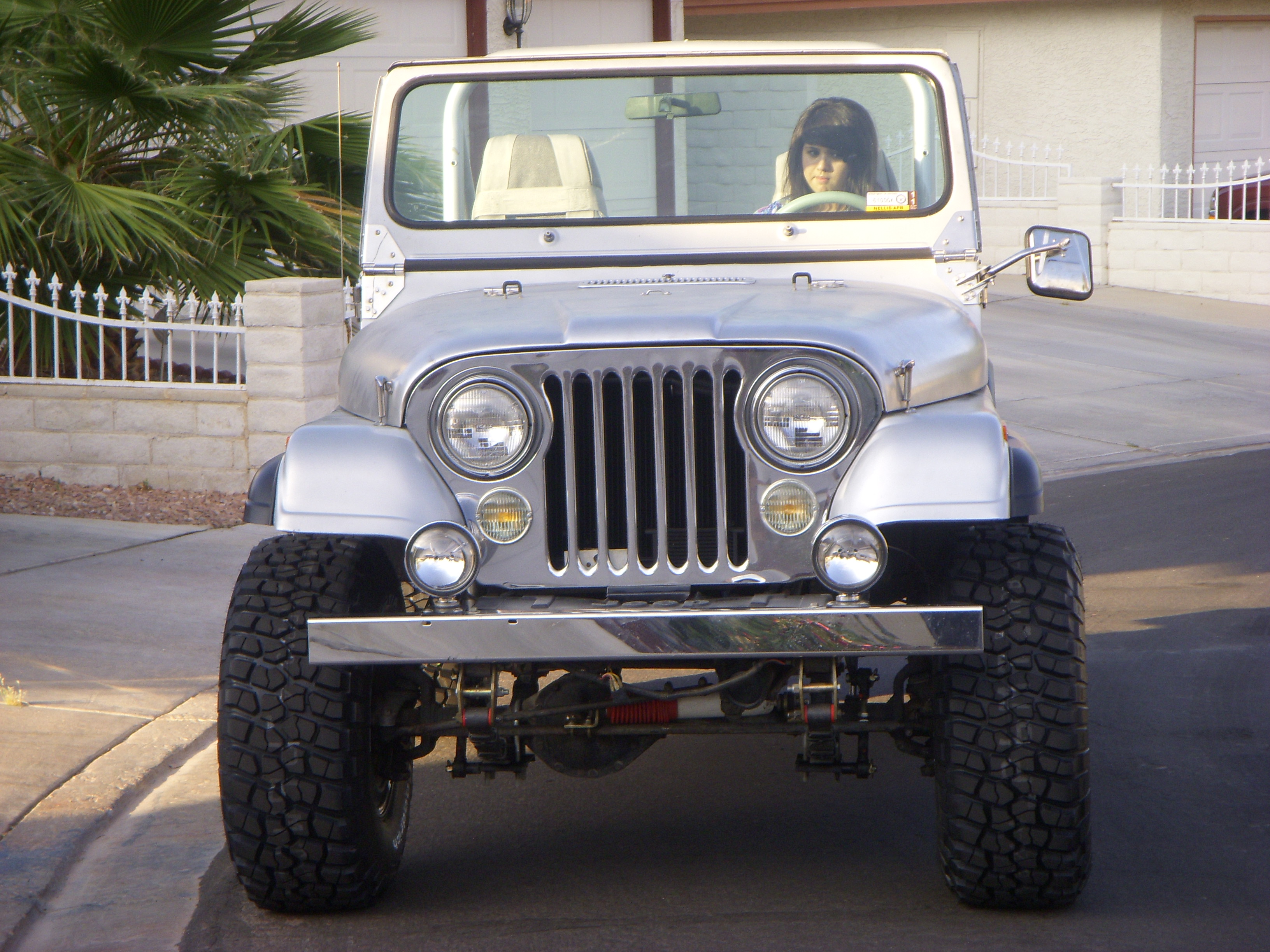

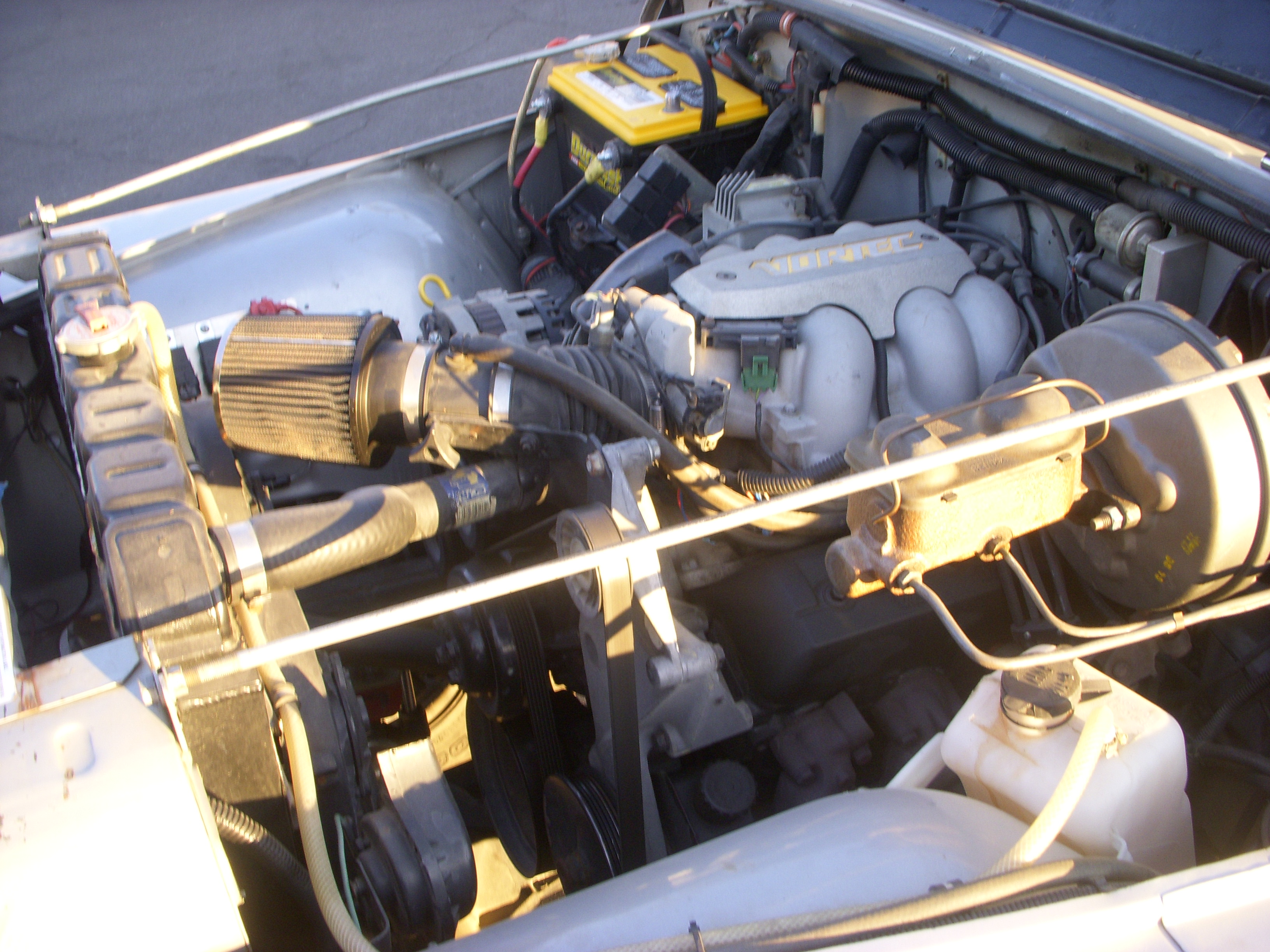

Here are some pictures.
Driver rear
Passenger front.
Drivers rear.
Passenger rear.
Thanks in Advance.
Do you have lift shackles installed? Could be the axle shifting due to long shackles, worn shackle bushings, or a combination of both.

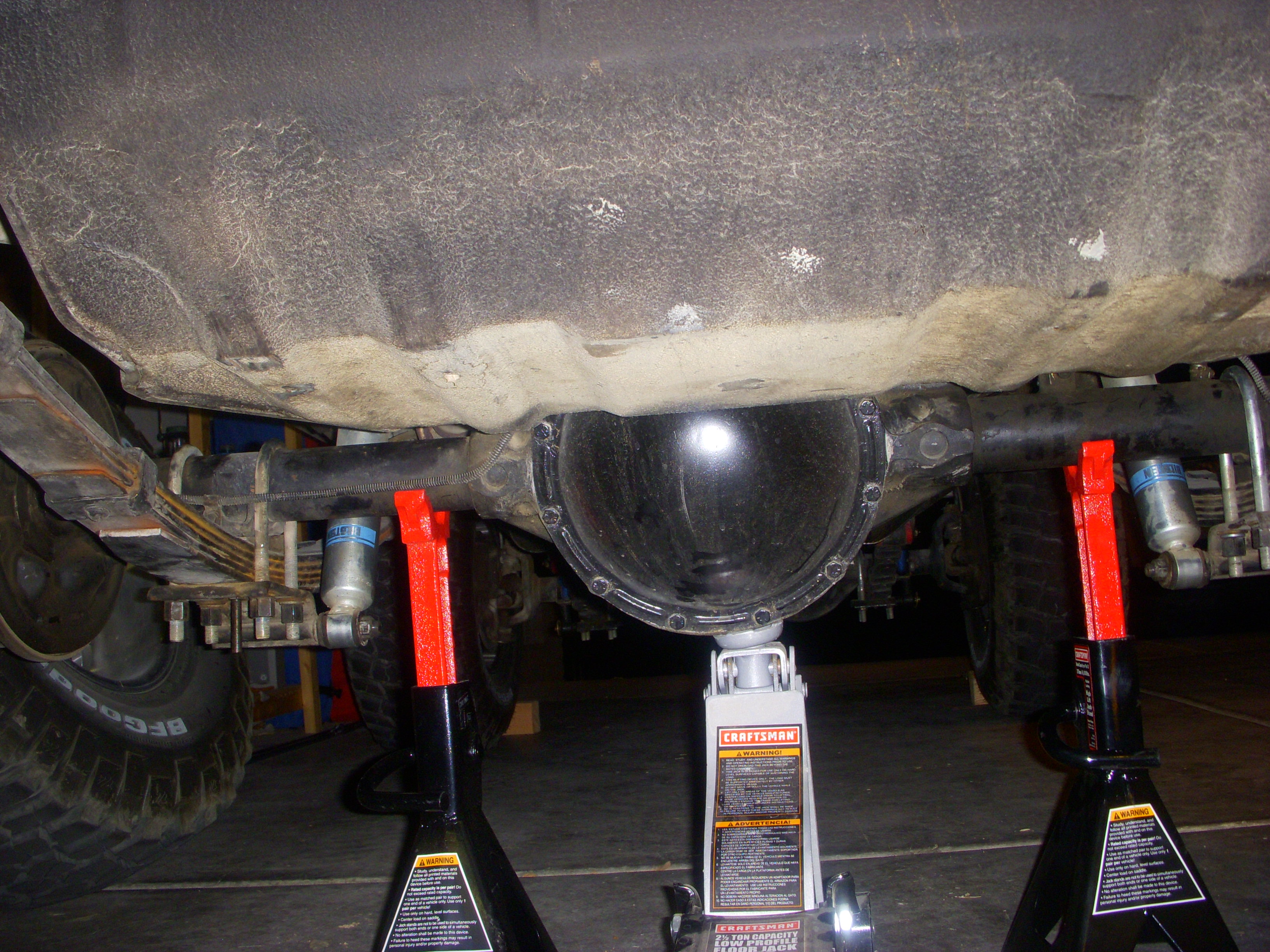

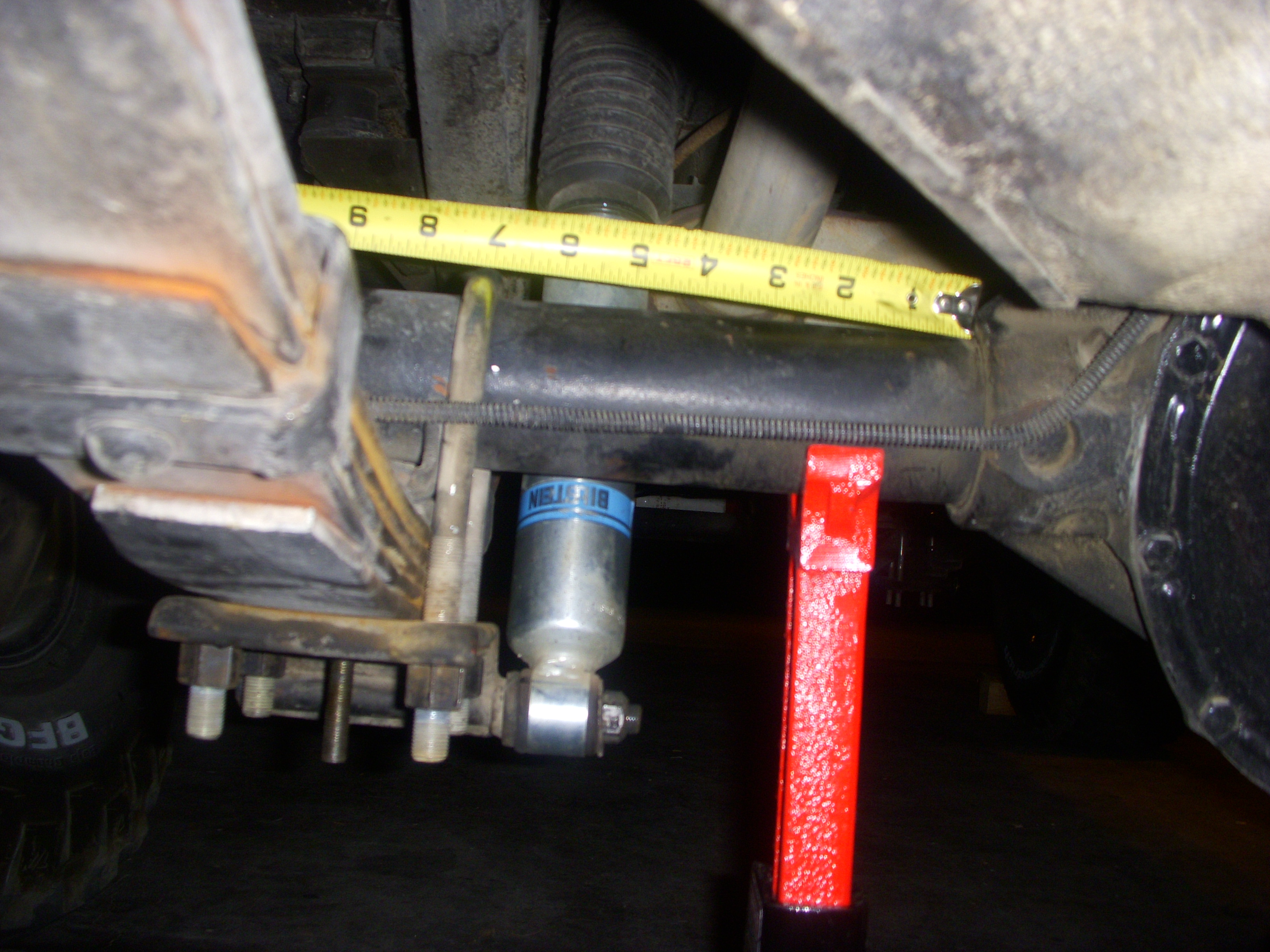

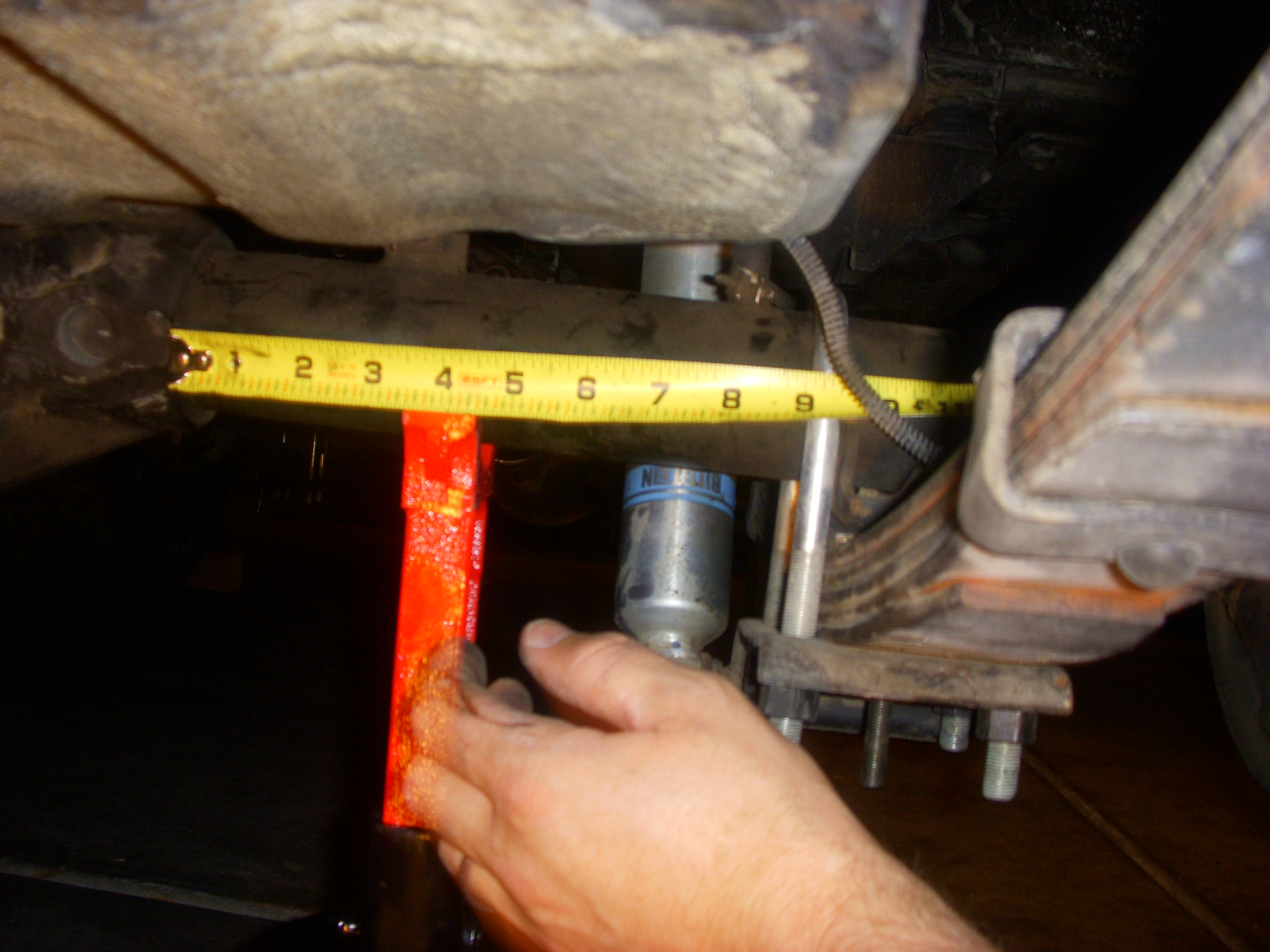

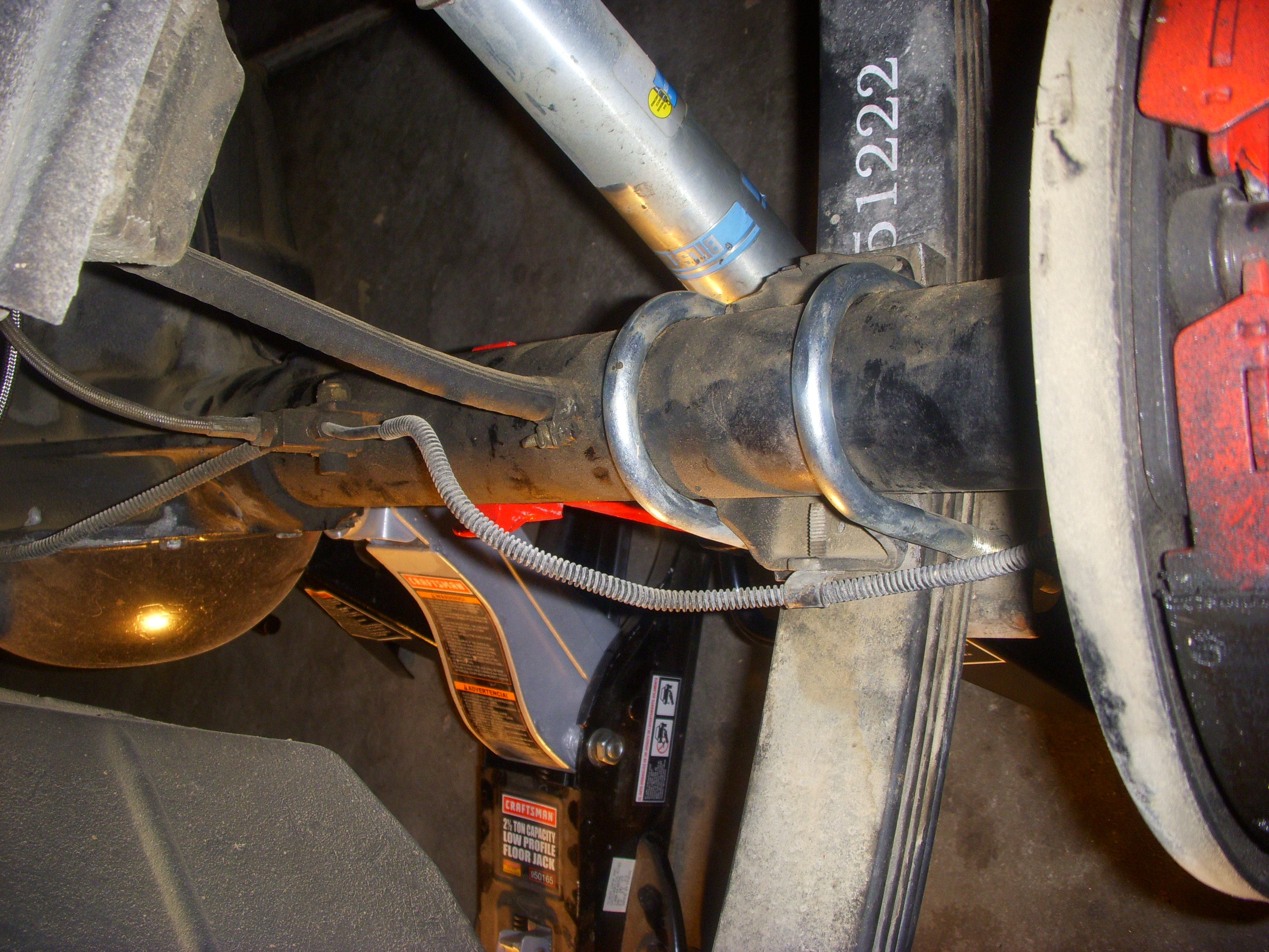

I just got it down off of stands. A LOT of axle grease all over the inside of the passenger side brake drum. I measured from the pumpkin to the leaf spring u bolts on both sides, here is what I got.
Drive side.
Pumpkin to farthest u bolt measure 10-1/4"
Passenger side measured 12-1/2".
Drive side...
Pumpkin to closets u bolt measured 7-1/4"
Passenger side measured 9-3/8".
I also noticed that there is a breather tube/line? on the passenger side housing that looks like it is in the spot where the u bolt should go to make each side equal.
I will post pictures on Sunday, the camera died.

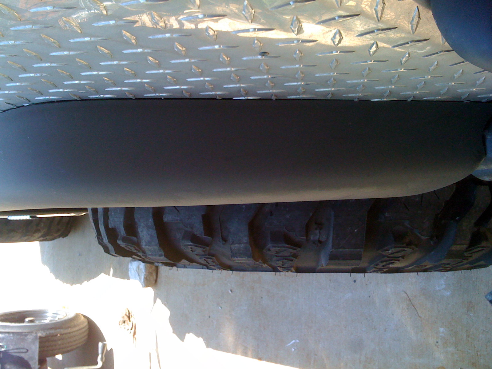

First off thank you for all the input I have been getting. I checked from the back of the drum to the side of the leaf, and both sides are within 3/8 of and inch of each other.
Here are more pics. 1st one shows that breather line? 3rd and 4th shows my original measurements. It sits off set to the passengers side and cocked in the wheel wheels. Towards the front on the drivers and rear on the passengers.

Yup, that's a Model 20 rear axle. The vent tube is where it's supposed to be. I will take measurements on my CJ7 with the same rear axle as yours for comparison. I will post as soon as i get it.
Since your rear AMC20 rear axle is a wide track and mine is a narrow track ,the measurements from the axle flange to the edge of the leaf springs(outboard) will be different from mine, However, it should be the same from the differential housing to the inboard edge of the springs. I measured 7 1/2 inches on the driverside and 9 5/8 on the passenger side. I also took a picture of the tires profile from the side to compare to the offset on yours. EDIT: sorry i forgot to flip the pics around.
