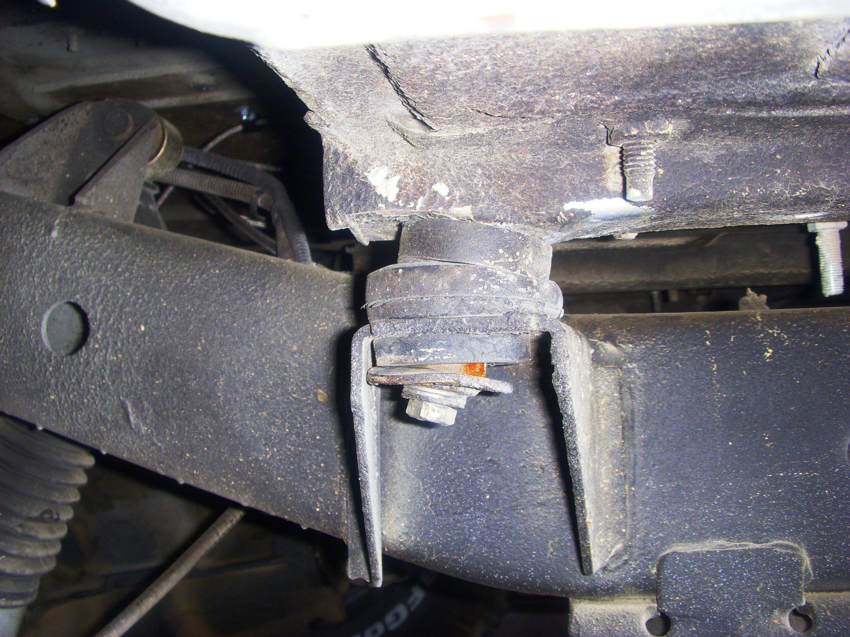

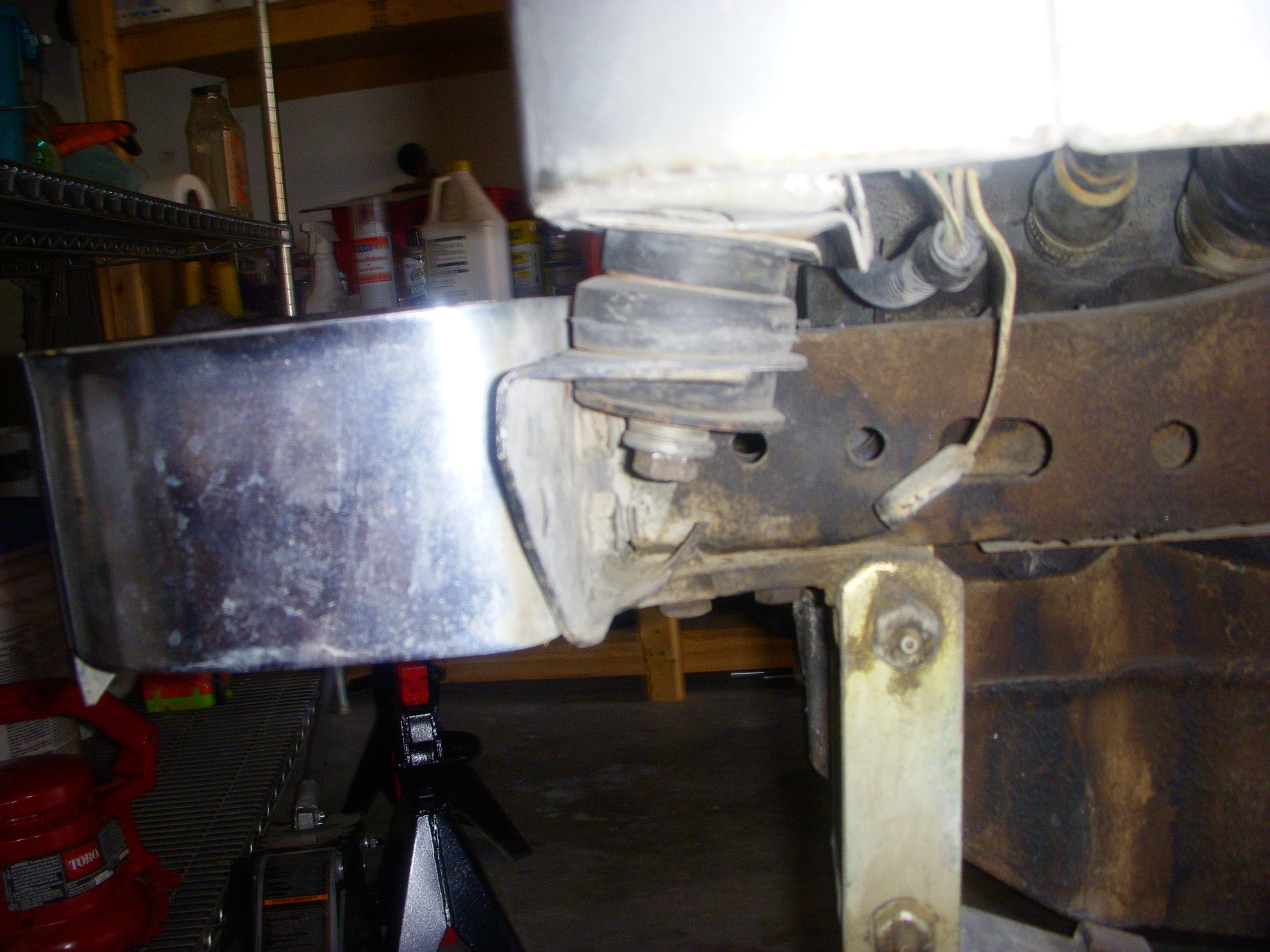

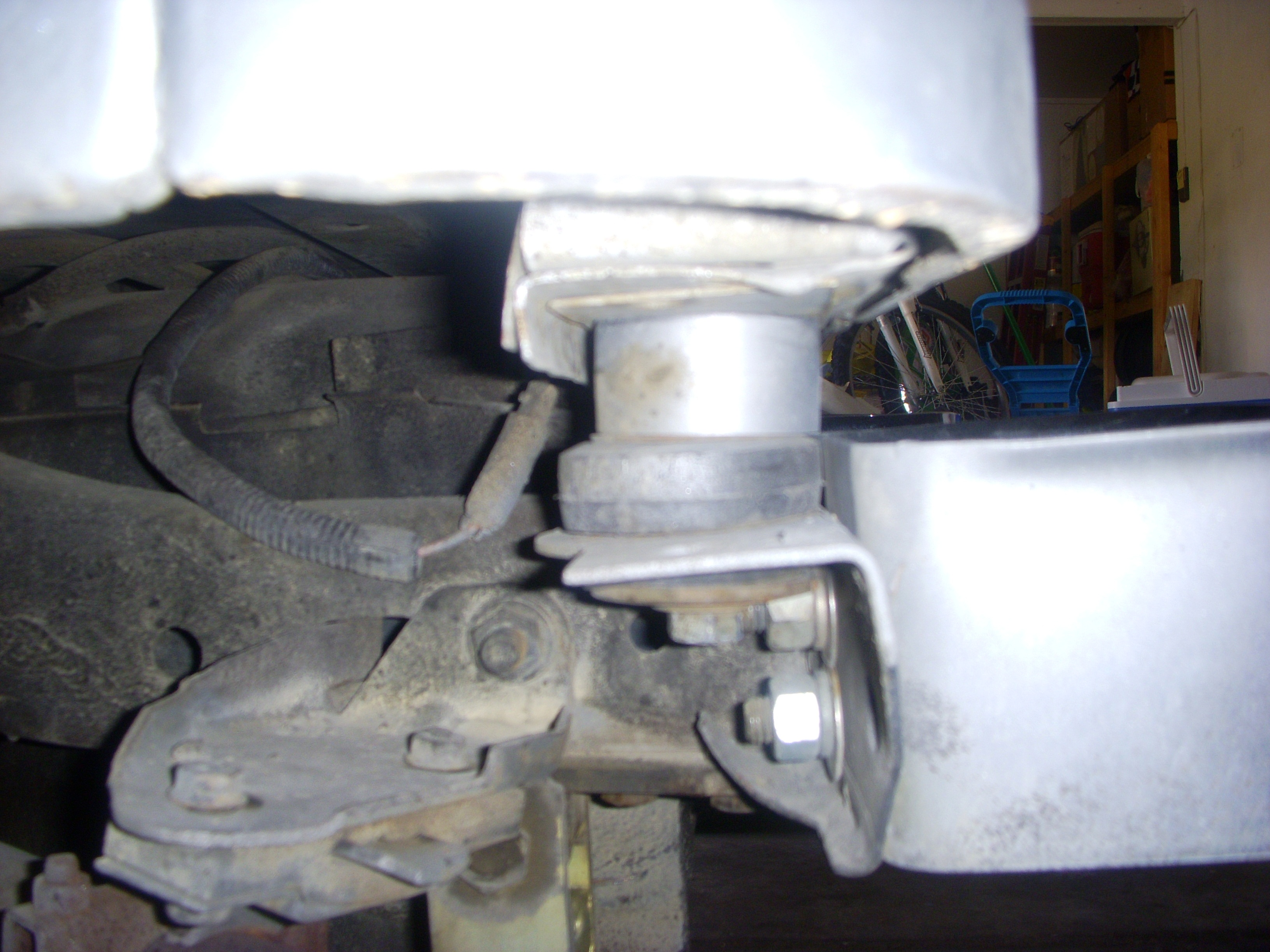

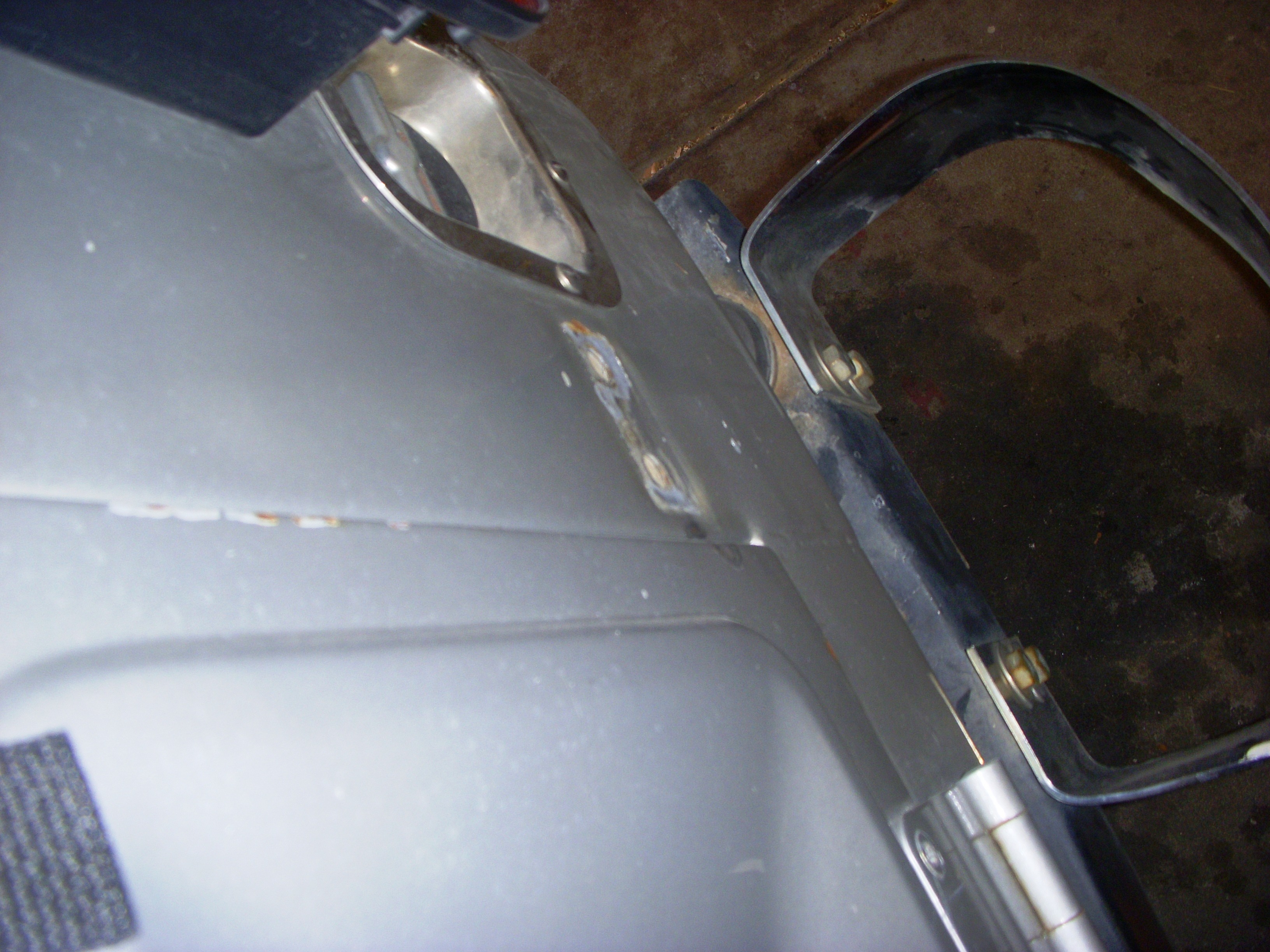

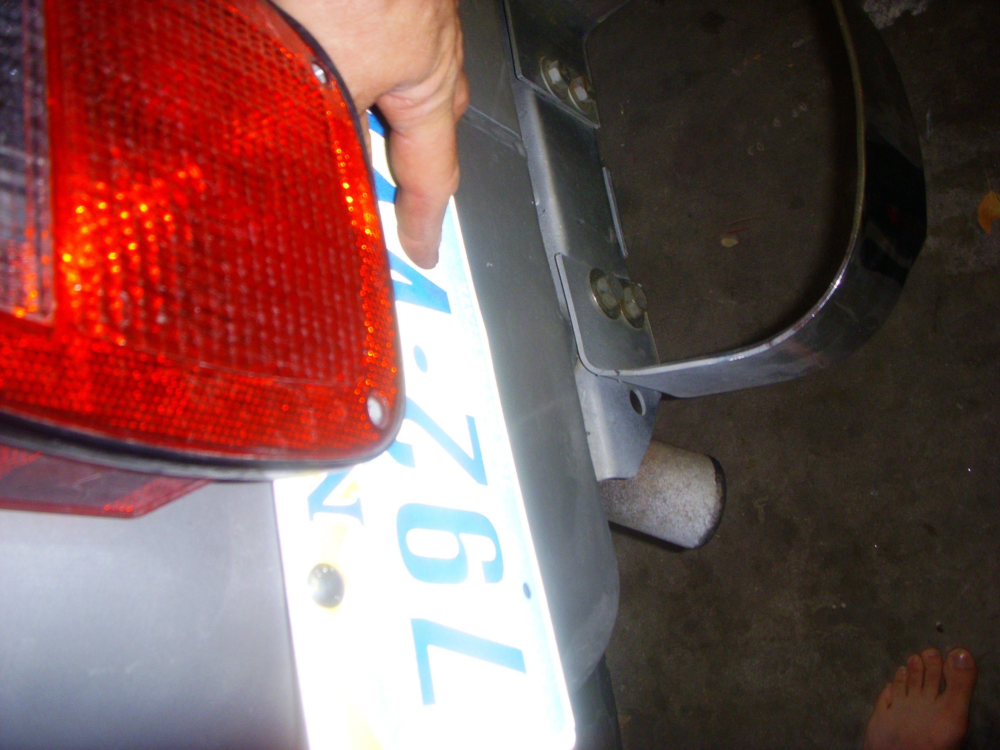

Well I know I need to at least put on a new body lift. After looking at the body mounts I have a good feeling that this is a major part of the problem.
1st... Is of the passenger rear body mount.
2nd... Drivers body mount.
3rd... Passenger mount in front of wheel.
4th... passenger side body rear.
5th... drivers side body rear.

Wow! that is jacked.. That very well be why the Jeep looks like it was going down the road crooked. That body is definitely shifted from the frame. And a BIG WELCOME to you..

It looks like the bolts didn't get torqued down enough and slid the Body mounts around until they seated crooked and stayed that way. It's amazing how a little adjustment can go a long way. Definantly put new body mounts on and I'm with the rest of the guys. That should fix your problem. Good Luck and Great lookin CJ!
