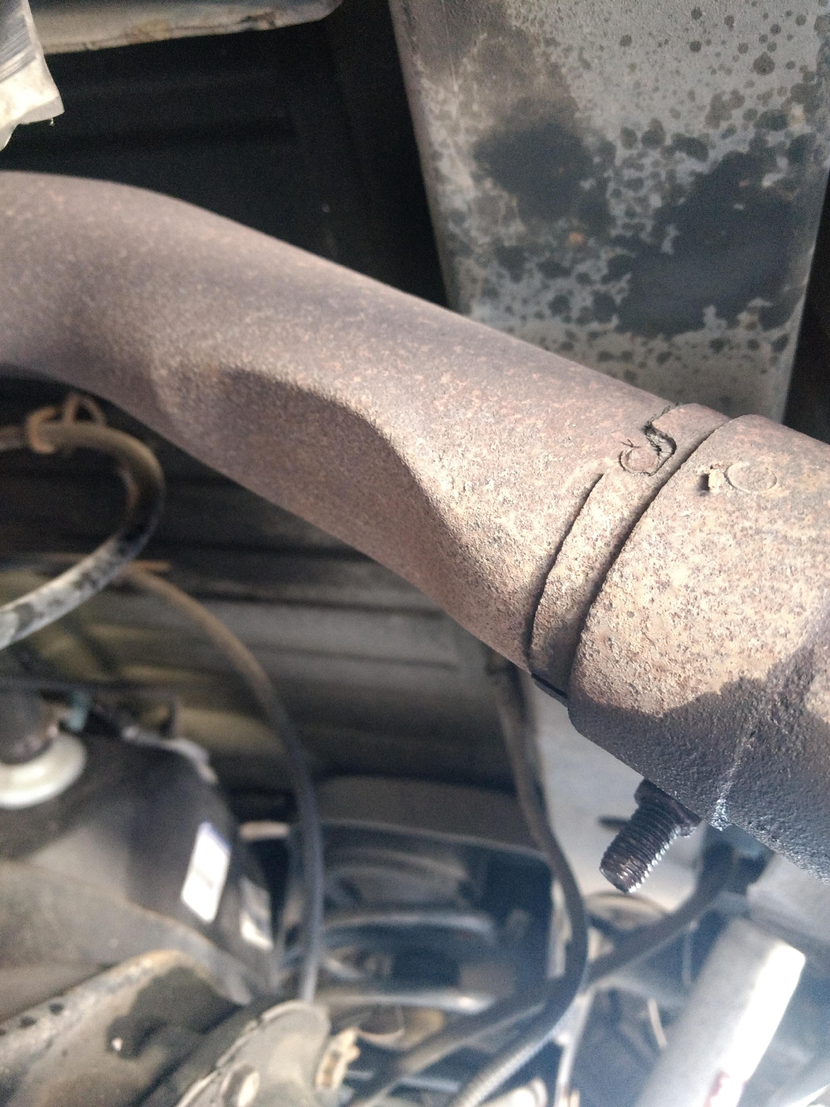

Hello All, I bought an axle back exhaust system and when I went under to remove the old noticed a dent in the exhaust pipe up further than I was going to replace. Is this enough to affect performance and I need to get a cat-back system? 07' Wrangler JK 2DR.

That looks like it's a placed dimple because it gives clearance for something. But it's also very old so I wouldn't worry about it.
Looks like an OEM dent for clearance. There shouldn't be any issues with the new axle-back exhaust system
