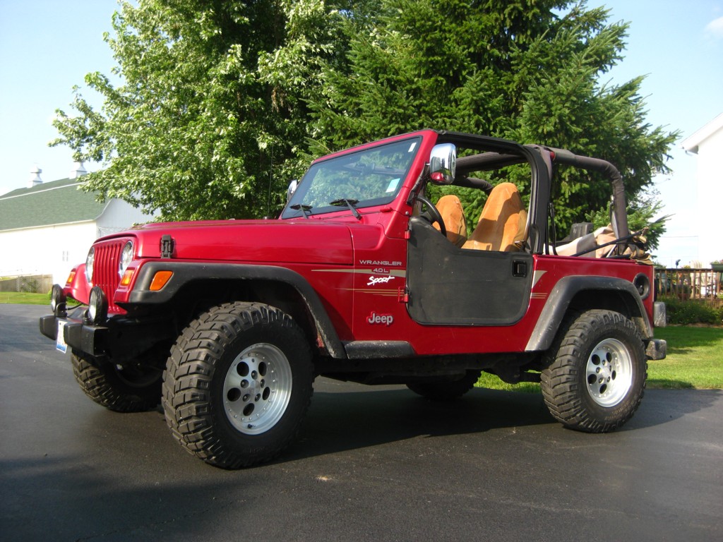

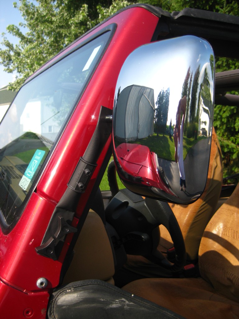

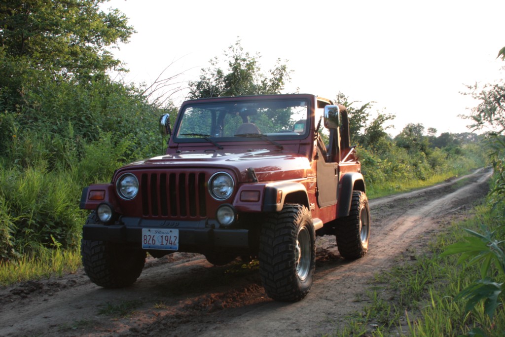

Cheap mirrors, open air and finally some summer weather
It was finally nice enough to put the half doors on and try out my idea for the outside mirrors. I picked up a pair of basic mirrors from Auto Zone, made brackets by flattening the ends of 3/4" conduit. I put a conduit clamp in the middle to allow for angle adjustments and painted them with truck bed coating. I picked up 4, 5/16 X 1 1/2" clamping bolts with the 3 sided plastic knob. I removed the two windshield hinge screws on each side and fastened my rig into them. Installation and removal is quick and easy. There's a little vibration at highway speeds, but quite tolerable to me. The total cost was around $20.

I really like that and it beats the heck out of paying 75.00 or more for mirrors!
WOW those mirrors are lookin good!!! and CHEAP TOO. And summer did finally just get here and now it's supposed to cool back down to BELOW normal temps here :cry: MAYBE down to double digits!!

The jet stream is finally moving north, so we are in for upper 90s this weekend. Up until now, temps in the 80s in Northern Illinois were rare. I've got the rig stripped down to the basics as far as cover goes, so I'm counting on no cold or rain for a while. That's why I made the mirror brackets easy to put on/off, because I know around here, rain can ignore the forecasters.
