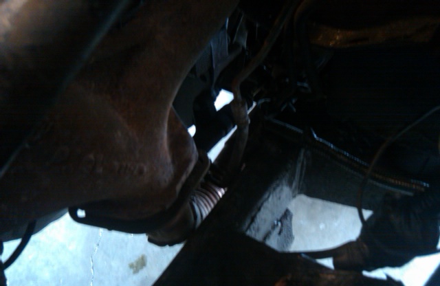

Steelheadz, Thank you for the info, I will have to post a pic but am not sure if "in frame" headers will fit on the left (drivers) side. The PO installed a hydraulic clutch and the actuator sits right off the transmission. I will snap a pic tonight and post it. Please take a look at your convenience and advise if you still recommend the "in frame" headers. Thank you to all of the posters, I am new to jeeps and am on a learning curve right now.
steelheadz, I have osted the pic I was referring too on my profile pics (I think). Sorry computer skills are not my strong suit. Anybody can take a look and advise if "in frame" headers will fit with the slave cylinder for the hydraulic clutch in the way.

Click on "reply" then when the new window pops up, scroll down and look towards the left side of the page where it says "additional options". here you will find the "upload pictures" button. Click on it and upload the pics you have then click submit. You can upload up to 5 pics.
Steelheadz, Thanks for the info. I have uploaded the pic. Thanks again.

A competent mufler shop that has a mandrel pipe bender should be able to fab you up with an elbow drop to clear that slave cylinder. I'd rather go that way than the fender headers that will constantly take the beating from the debris that get's slung by your tires and not to mention the possibility of your tires hitting it on sharp turns. Besides that, it's ugly to look at IMO.

I am with Steelheadz on the in frame i had hooker fender headers with a 3 inch lift and 33" tires on my 74 and was always tire grabbing when turning left not a good sound or good for equipment and wheel I am sure there is a good set up for them but i actual just went back with the stock exhaust manifolds and flowmasters. I did research the in frame and would have went that route money permitting.
The only downside to the in frame type is wrench clearance when working on clutch linkage in CJ's of my era.
