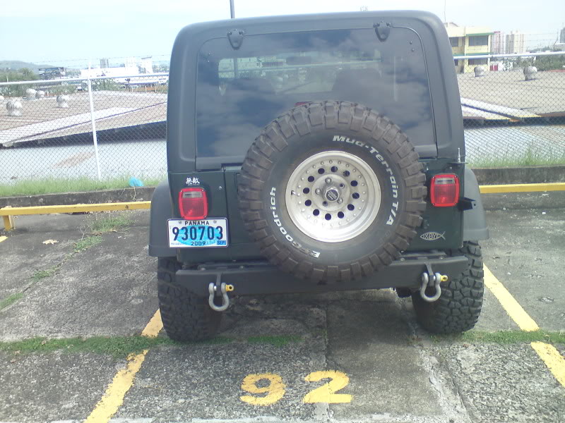

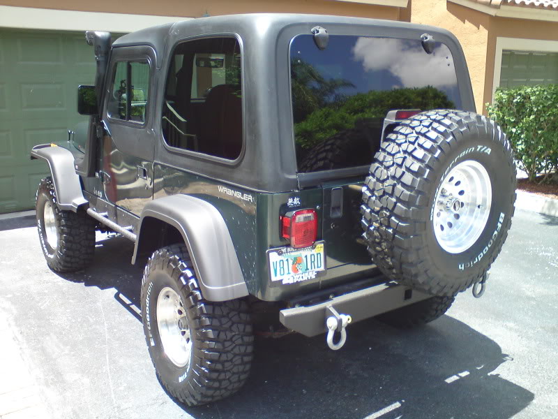

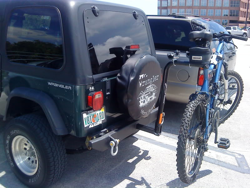

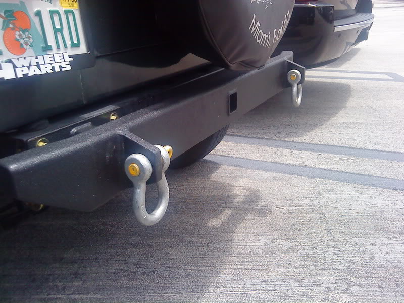

One issue with those bumbers and why you don't see a lot more is because they are not ment to actually tow. they attach generally to the rear cross member and maybe tie into the frame in one or two locations on each side of the frame bottom. Not very strong and the manufacturers don't want the liability. the rear cross member is super flimsey and those bottom bolts are only single sheer and not strong at all. even a Grade 8 bolt has the same single shear strength as a grade 5.
The Jeep is not so great for towing anyway because of the short wheelbase, so I dont plan on towing anything over 1,000# anyway, which means I should not worry much. As for the shear strength, even the front bumper (where the winch is mounted) is only held on by 4 bolts to the frame (which is what Hanson recommends), and this is strong enough to tow the Jeep out of a mud hole... Also, the
HighRock 4X4 one was tow rated IIRC, if you are looking to tow (I did not like the fact that it was open on the rear, which means all the mud from the rear tires ends up inside the bumper, but it's the only one tow rated).

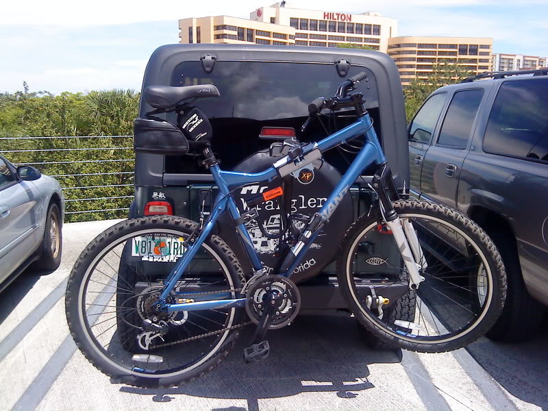

He's looking for the front not rear, would look To add sweet bike, you must be a tall mofo
I'm 6'5", so yeah... To be honest, I was quite surprised when I tried the Jeep the first time (when I was buying it) that I actually could fit without isses! And I like the bike too! Costa Rica has some nice mountain trails to take it down from, so I'm happy I brought it with me!
