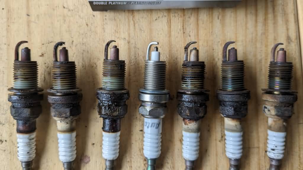

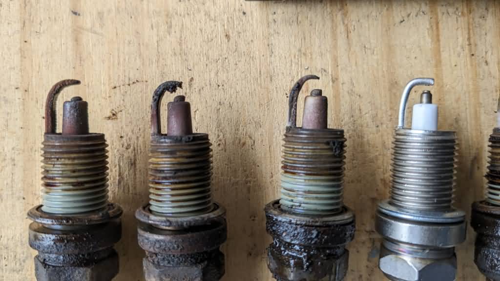

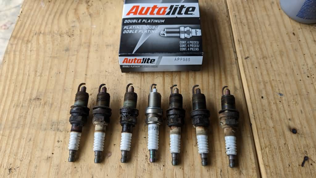

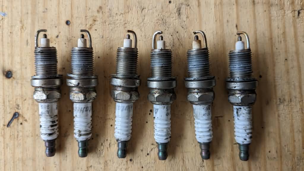

Here are the old plugs, with a new (properly gapped) one in the center. Some of the old plugs have a gap of 0.085!
First the electrodes in the all of those look like normal wear. I change mine every 30,000 miles. I was closely monitoring in miles per gallon and when I saw it drop and that?s when I change plugs.
Plugs come pre-gapped to the proper spec. If you had to open them, they were miss handled, and I would inspect the ceramic.
From left to right the third one in looks like you have a severe oil leak. Looking at just the top, all of them have enough carbonate oil on top to be a problem.

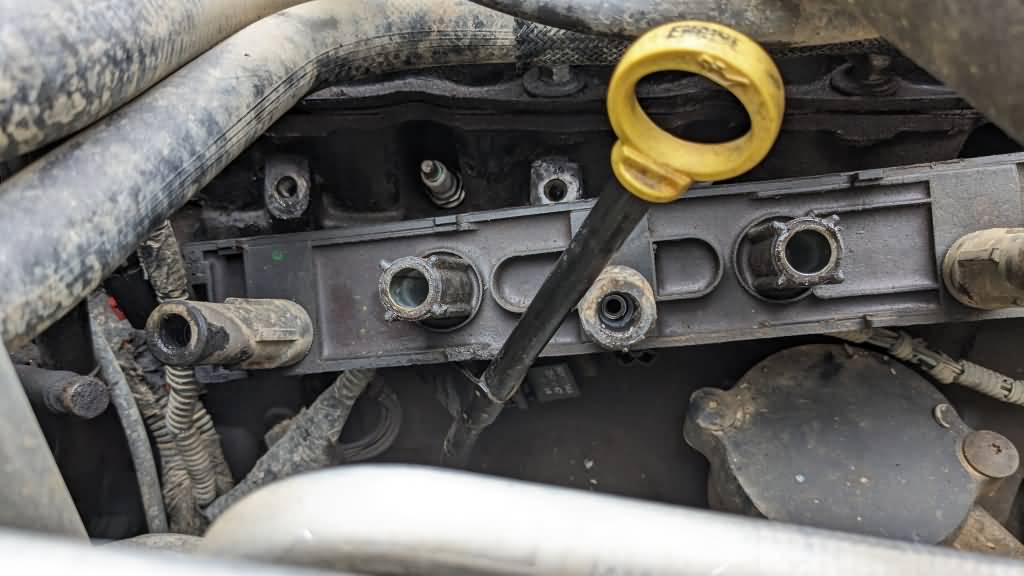

I would inspect, the boots on the rail and make sure they?re clean and not cracked. Second thing I Will inspect that I didn?t crack the ceramic installing the plugs and look for burn marks to where the ark might be jumping.
Then I would reset the PCM codes so that you lose stored data. This way you could start with a fresh set of data that it?s going to create with the new plugs. Your misfire might be a too rich programming from the old plugs.
What you did with dielectric grease sounds OK. It won?t block the charge. Also, I do not use anti-seize. if I were to use it, I would use it very sparingly. See tips below.

What would you clean the coil rail with. As you mentioned cylinder 4 was coated in oil. I've got plenty of brake cleaner but I'm wondering if this isn't a job for electrical connection cleaner.
I may throw a new spark plug on cylinder 4 and clean the coil rail and give it another try.
Sent from my Pixel 6a using Jeepz.com mobile app
I?d be afraid the brake cleaner will dissolve the rubber boot. I would just wipe the rubber boots down with dry cloth getting as much of the caked-on grease off. Then a towel of soapy water. Don?t soak it just clean the grease off. Clean inside with a Q-tip.
Make sure when you tighten down the rail you tighten each bilt a little then the next ? just like a tire don?t torque one down then the next? this way, you know each plug should be touching it?s terminal.

I cleaned the coil rail boots with electronic parts cleaner, using a soaked Q-tip to get the insides (thanks for the good tip). The Q-tip needed to be changed a couple of times, as it was pretty greasy.

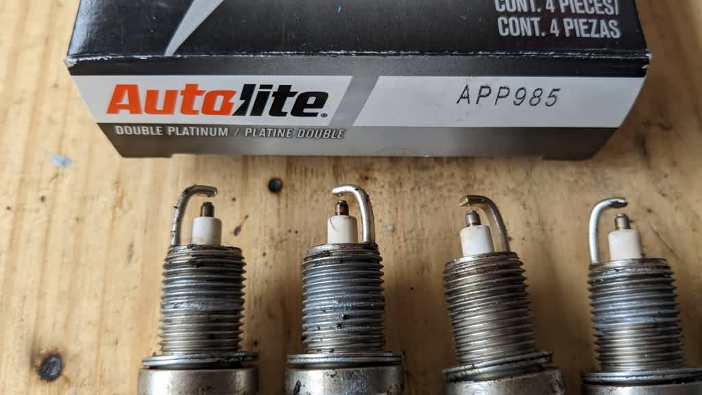

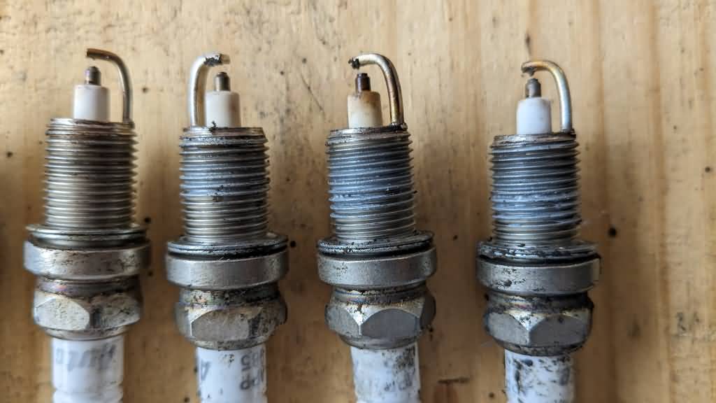

I then went to Advance Auto Parts and bought a set of Autolite XP985. This is the more expensive Iridium plug. I pulled out the old Autolite APP985 plugs and took a long look at them. These plug plugs have less than 5 minutes of run time on them:
Cylinder 6 -> 1
The second plug as a noticeable crack in it. I'd bet that the crack would be very hard to see until it has a bit of dirt / stain to it.
6 -> 3
4 -> 1
With the new set of plugs, everything runs great. Looks like I had a bad plug right out of the box.
Props to Advance Auto Parts - they let me return off 6 of the APP985 plugs as defective. I'm now running the XP985 plugs.
If what i see is real 3-1 have deposits.
All of them have caked grease and dirt even where the boot covers them. That?s bad. Sorry to knock you but you have to know.
2 has uneven spray or clocked 180 from the valve
Is the crack because you gapped them? As noted they should be dead on out of the box

As to the crack - With the old set, I put the gauge on each plug, but didn't have to change any gaps (or pry on the plug). I just verified that each one was set correctly.
With the new set I installed, I just held the plugs up against each other and eyeballed it. I didn't use anti-seize or dielectric grease this time, just trying to keep it simple.

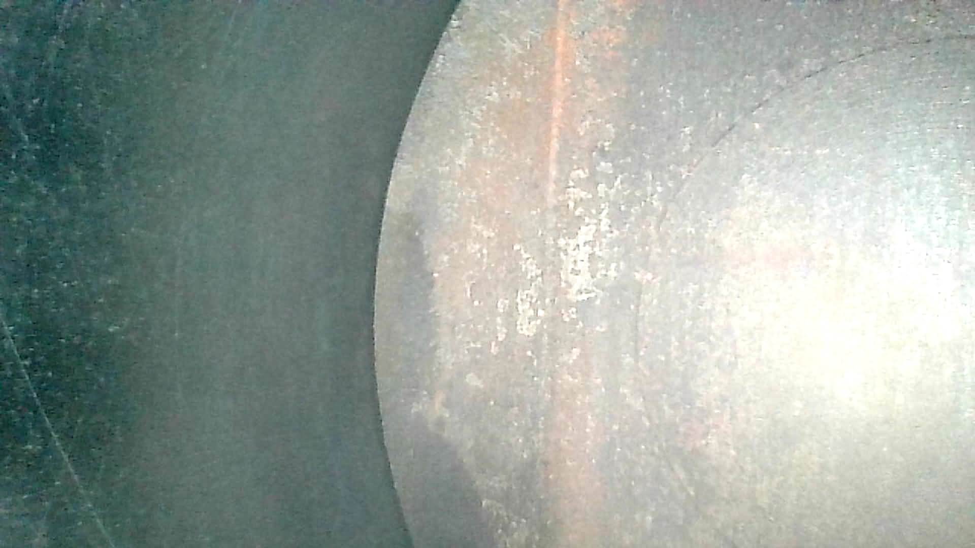

After another 50 miles or so, I ran a borescope down the number 1 cylinder. What do you guys think?
Pretty clean
Run can empty then shut engine off and wait 30 min then drive hard. Thats where you will get the smoke. When running it into the engine you want to nearly choke the engine.
id be more interested in the valves specifically where they seat.
This is where buildup. Caused misfires.
Now every 3 mo drive in 2nd at a speed your rpms go above 3300rpm. This is where the are designed to be free to turn. By turning it gives other areas the buildup spot snd the buildup a chance to burn off.
