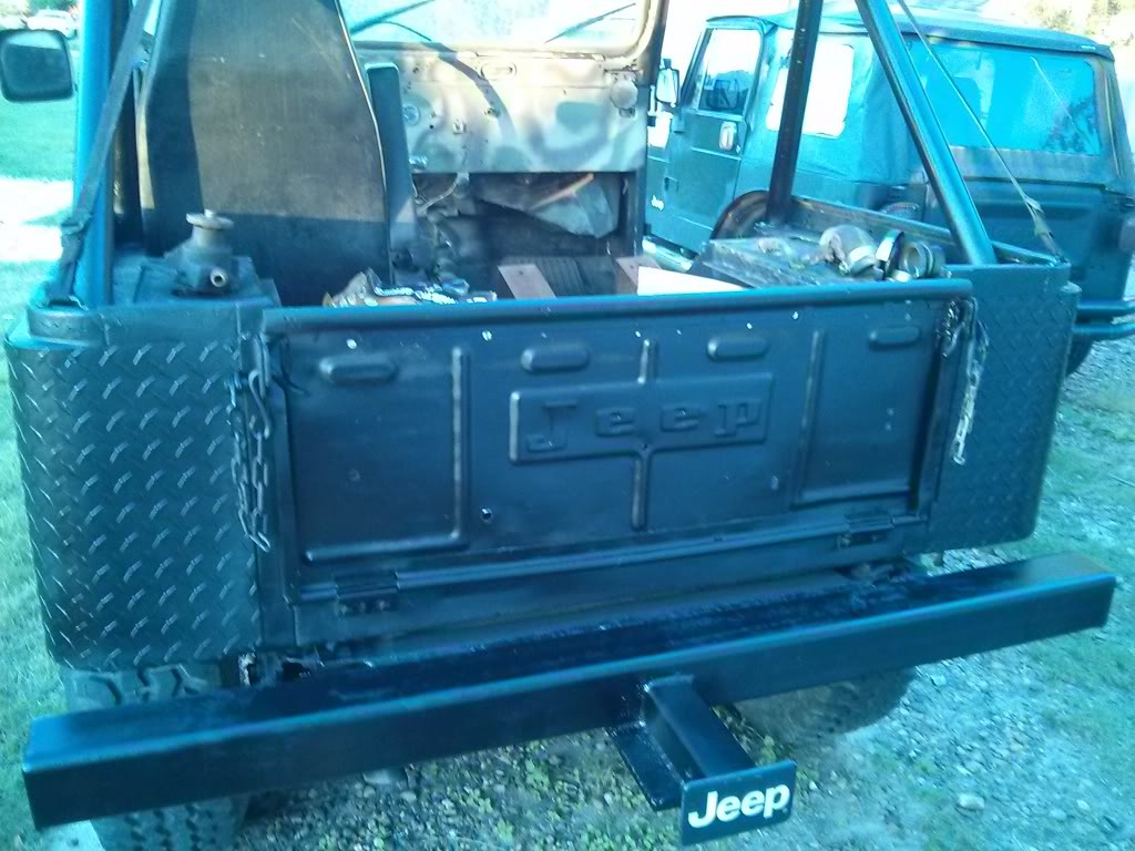

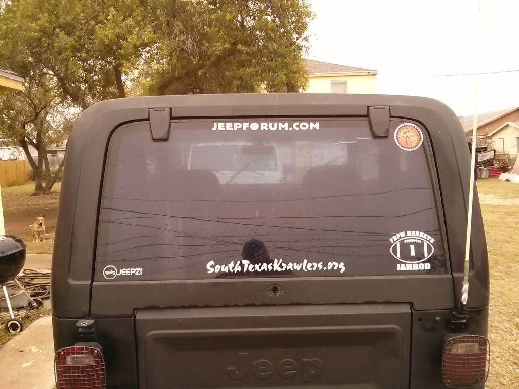

I did mine this past summer. The hard part was getting the nuts in the part under the tailgate for the hinge. It was really a pain. Other then that, it came out super but my hardtop is a no go now. It takes two people to open and close now because yj hard tops have a lip that require they be closed before the tailgate. With a softop though, its perfect.
It didn't take hardly anytime to do though
I should have done this type though because I like this one even more. It measure wider then the yj/cj style ones so I didn't do this type but once I got a cj5 I see why it measures wider, the tailgate closes on the outside so that extra bit is the overlap. The tub measurement is the same for this tailgate and our style tailgates but since this closes like an old pickup, it has to be wider to go past the tub edge
