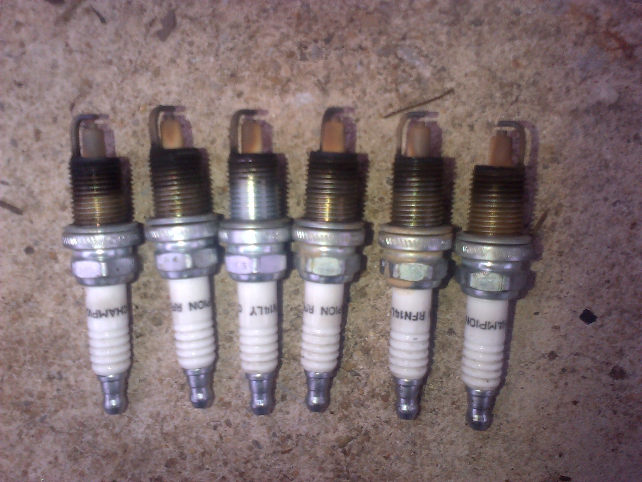

When was the last time you pulled the spark plugs? What do they currently look like? This will be helpful in identifing your problem.
the regulator is set on 4psi and the plugs looked pretty normal, the typical tan/brown IMG-20130723-00139.jpg color and #6 had a lil grayish i look but not bad the plugs are in order from left to right 6 to 1
So..... Let me ask a few questions. Do you have auto or manual trans? Do you recall doing any repairs or maintenance just prior to the start if your problems? When you say it will redline, you're reving it in neutral? With your current set up, does your fuel line split and return to the tank?
its manual and yes it will rev all the way to the redline without any misfiring or anything, it happened about a week after i regeared the rear axle, and about a month before that i had a bent intake valve that i had to replace. think maybe that could have something to do with it? the fuel lines are basically like stock only i have an inline regulator between the filter and carb, ive also checked the return line and it flows properly.
