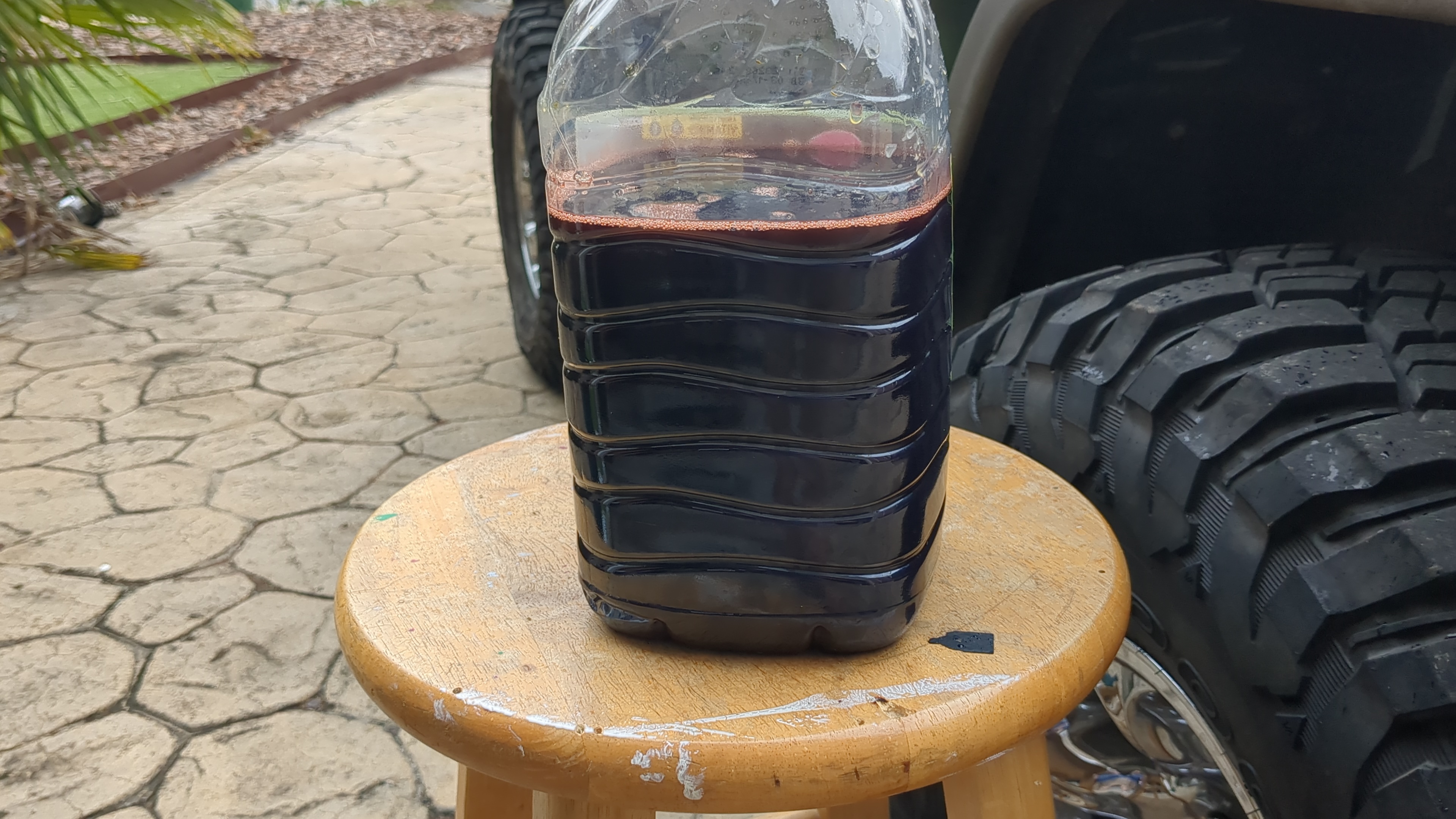

How bad does this fluid look to you guys? It doesn't smell like anything (no burnt smell)
Dot some on a white napkin,
Paper. Not the silk ones you used last time.
Looks dark but it could be the lighting or something.
I had to send the butler out to whatever store isells paper napkins, but here we go.
Sent from my Pixel 6a using Tapatalk
TP works
Fresh TP
Thats kinda brown.
Some red showing.
Run it a week and do another swap. Each dump and fill changes ~30% dump and fill app 6 times and you will have 80%-90% new fluid.
