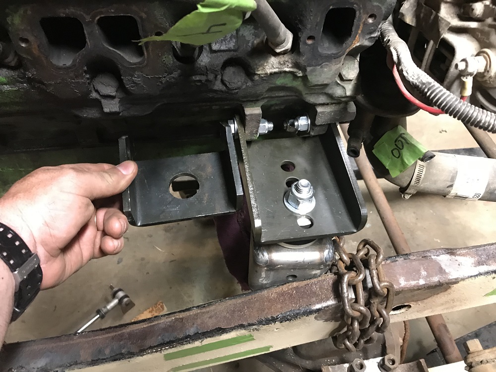

    Then after a nap, and some freshly grilled hot dogs, I went out to put on the new motor mounts that Advance Adapters sent me. You can see the first set was not gonna work...

    Guess who has motor mounts, and shock towers welded in?
    Well, that happy feeling didn't last long... Guess who's brain damage, coupled with the inability to think in hot weather caused him to have the guy weld the motor mounts in the wrong place?
    Having a TBI is not fun. I'm always forgetting things, losing things. I took off the rubber isolators and bolts, but to prevent me from losing them, I put them on the bolts... Now the guy shows up to weld, and I position the mounts without the rubber... He leaves... I remember the rubber... the engine sits too high with them, or just right without, but then it's mounted solid. I try to put them in, and the holes don't even line up. I remember from when I had the tub on, I should have room, but I really didn't want it that high anyhow. There is another issue...
    The Jeep didn't come with this powertrain combo, and I had used the original trans mount (a new one) just to locate the engine in the frame. This places it in the correct place (front to rear) but a bit too high for good drive line angles.
    So now I have a new plan... I have to modify the motor mounts on the engine block. Cut off the flat part on the bottom, and have it welded to the top, lowering them over the rubber isolators. Also, I don't need 4 inches of room between the transfer case and the skidplate, so I plan to have a machine shop remake me one bracket (red arrow) 1.5" shorter.
    It's in for now, but it won't be in for good, for a while... I just don't want a complete fabricated solid mounted home made welded in set up like it had in the CJ5 it came out of.
