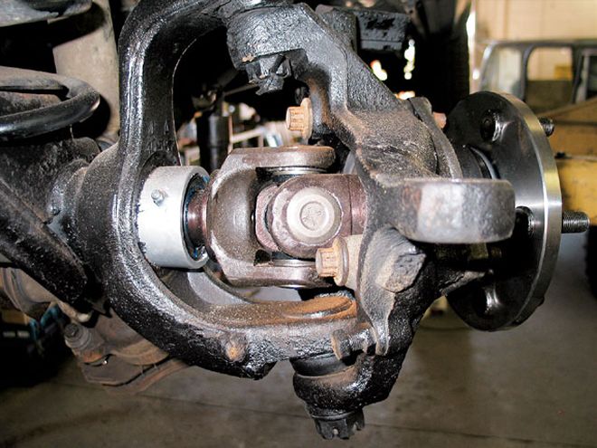

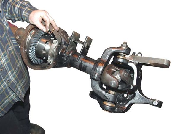

I have just changed the front RH hub bearing in my hunt for a noise up front somewhere but it has not cured the problem. It is speed related and in time with the wheel revolving.
I began to think it was the bearing the end of the axle tube behind the UJ but having looked at some pictures on the net it seems that there is no bearing at this point and that the shaft is only supported by the hub and diff carrier bearings. Is this correct?
Attached are two pictures I downloaded. In one the UJ is very close to the end of the axle tube and in the other there is a gap with a white collar with a grease nipple. Mine has the gap but no collar.
Both pics are supposed to be of a Dana 30.
Can someone please tell me what the collar is and why the difference in the two pics?

First the wheel bearing is inside the hub area where the wheel studs are.
Second the greasable collar is an axel tube seal. Is it possible your two picks are from two different vehicles? One modified?
Some have a non grease type. It is flush with the tube end.

The first pic is an aftermarket axletube seal designed to keep muck out of the axletube.
Axleshafts are located by the unit bearing and the differential carrier.
Thanks for the info. I think mine must have the flush seal. I was just surprised that there is no bearing at this point.
