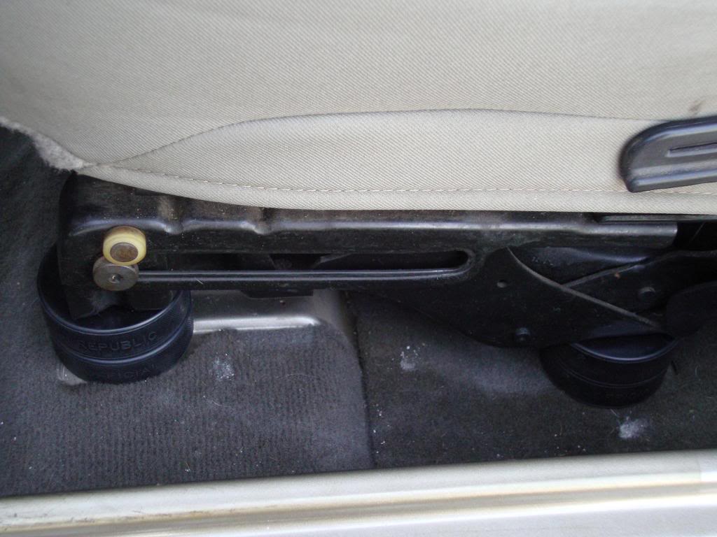

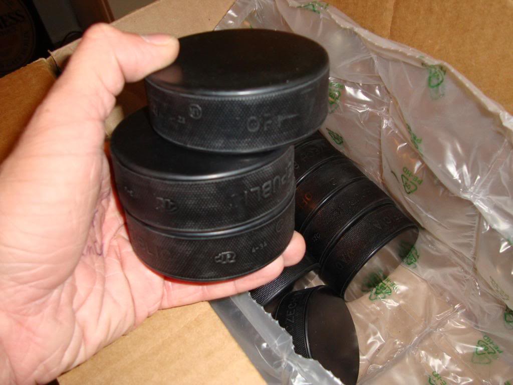

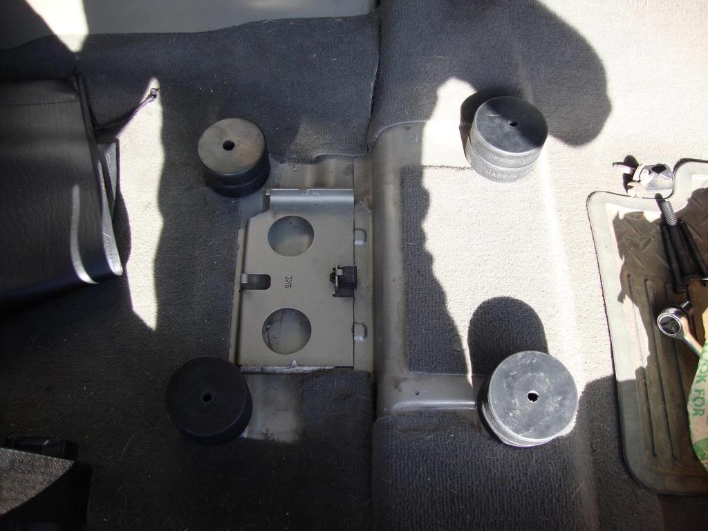

I used two hockey pucks under each corner of the seat frame (total of 8 pucks). This raised the seat two inces and allowed me to see the front fenders. One other thing to think about... This puts more stress on the bolts (which you need to change to longer ones). One of the bolts is different and mounts the seat belt. The bolts are metric (on my 05, anyway). Now I can see where I'm going :lol: . Best of luck - John
Hockey pucks? Thats awesome! Hadn't thought of that. I checked into that site mentioned above and the guy called me this morning. His 1 1/2 inch lift is $65, then shipping (about $11) and CA sales tax. On the upside he offers a 10% Military discount, but I opted to do my own thing and not pay 80 bucks for something I can do for $20 or so.

Well, it took me a while (do you know how hard it is to find hockey pucks in San Diego!?) but I raised my seats 2" and LOVE it!!! Should have done it a long time ago... Total cost (including the T-50 socket I didn't have..) was $34.50.
