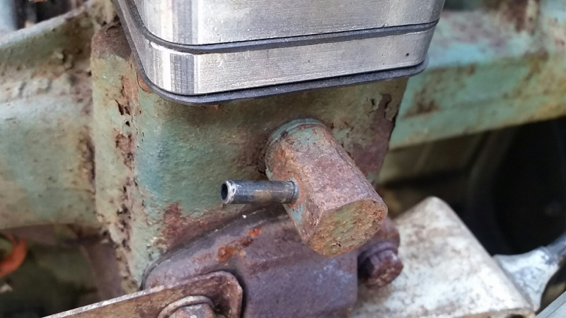

Back firing went away when I put on a filter on the PCV valve. Hope that's the right thing to do.
was that hose hooked to the pcv sucking air? (pulling vac). As I understand it, the pcv valve sucks unburnt fuel mixture back into the carb to be reburnt. so it sounds as if you are running rich and igniting unburnt fuel through your exhaust (back fire). not sure why the filter stopped it unless maybe the more air being sucked in by the filter diluted the mixture to the point it wouldn't ignite. This is a guess and not a sure cure, but I would try buying a new pcv and adjust the carb leaner. Their shouldn't be a filter on the pvc, it has to pull vac from the engine not the atmosphere.
