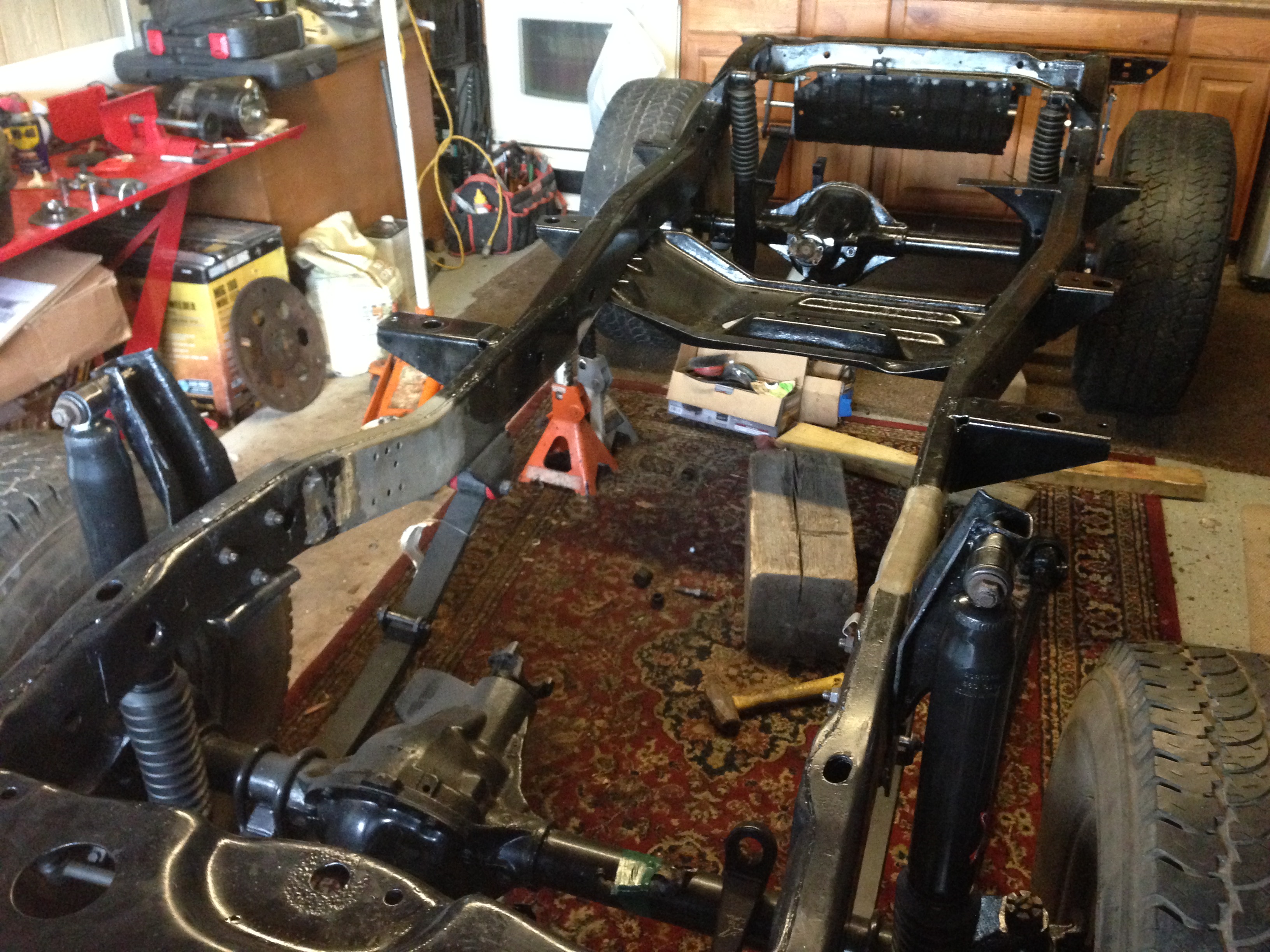

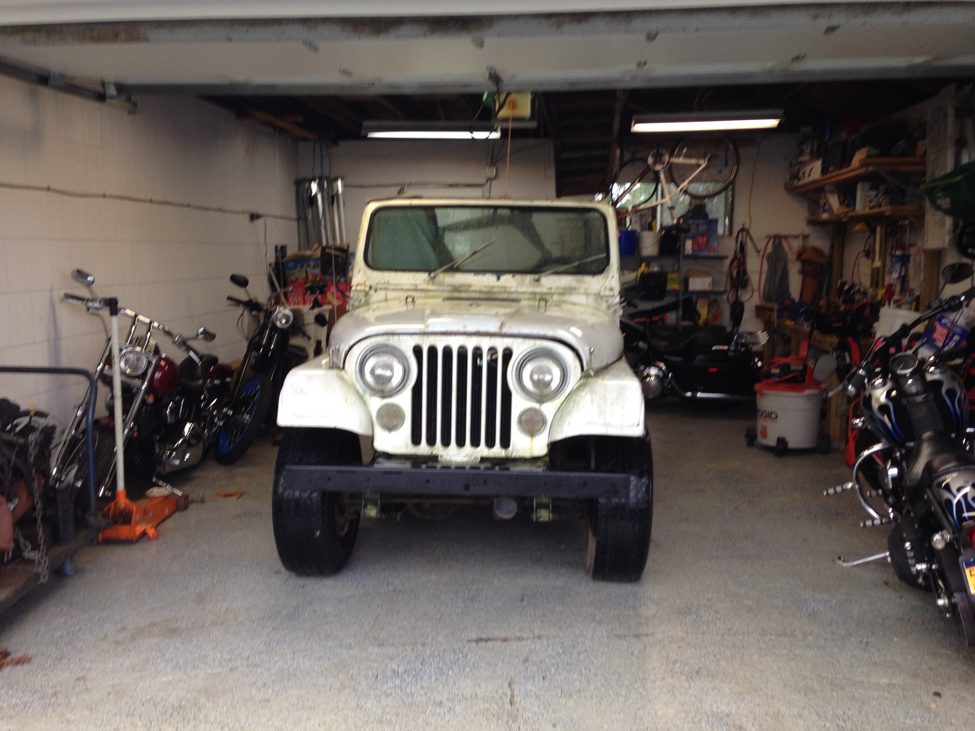

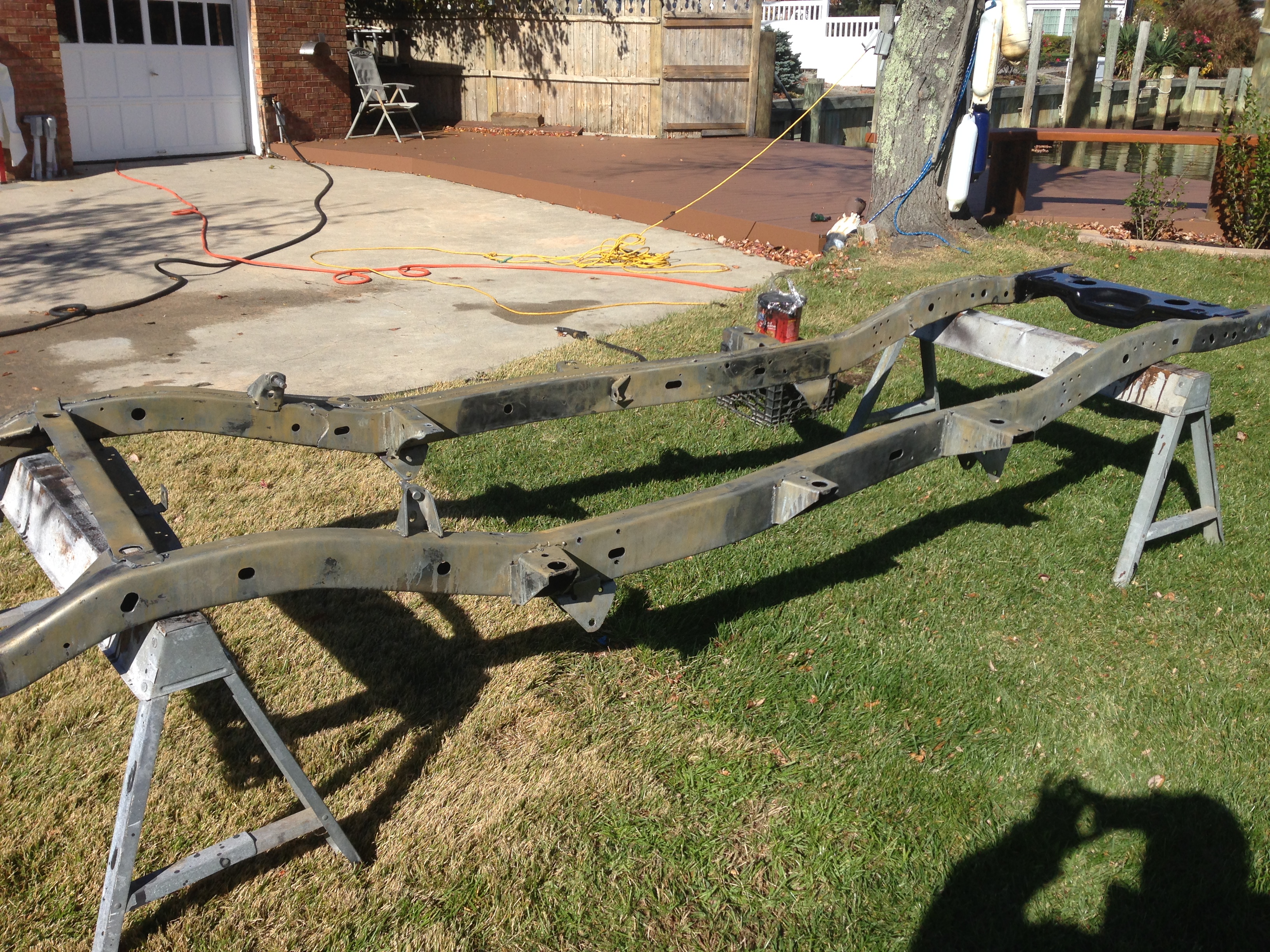

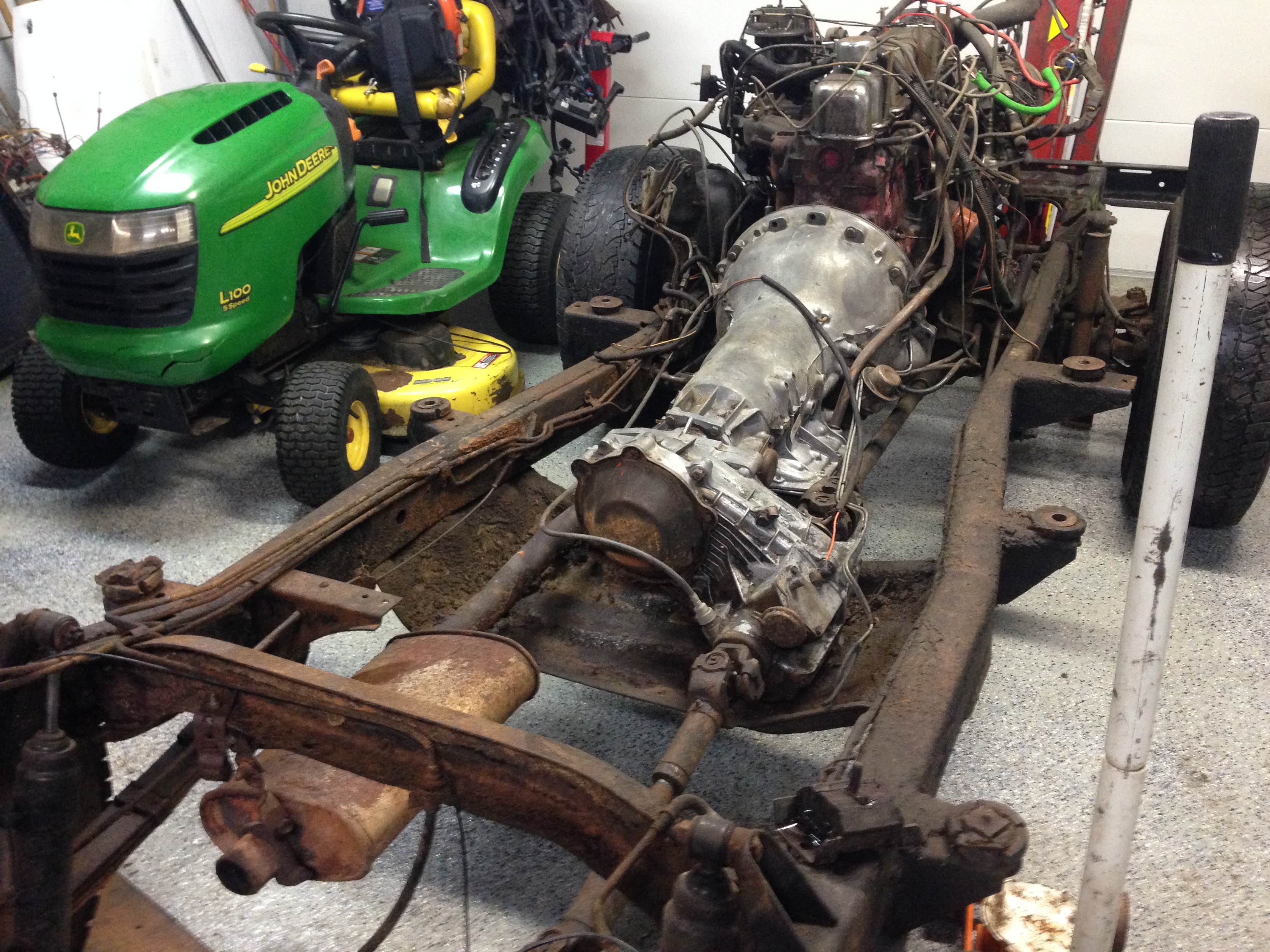

Started with a Full running Jeep - Frame was Rusted - Replace the Frame with a none rusted one
sand Blasted it and Put Por15 on frame and axles, Has Anybody Used a Fiberglass Body we are in the north best and want to avoid rust
