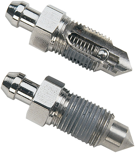

Look on-line for "Speed-Bleeders". They're are $4 or so a piece (x4). You just crack them open, pump your pedal, and a one-way valve keeps the air from coming back in. Re-tighten, and all is good. It's worth it if you wheel it much. OR, pay some neighbor kid $1 to pump it for ya. Don't give them candy for it though......might look bad. I wouldn't offer him a beer either.
