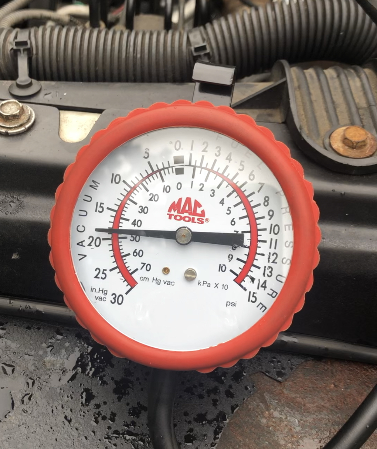

Ok so the mechanic that did my engine lent me his vacuum tester and I took some video but I can not upload it here so I got a still of where the gauge was sitting at an idle around 750 - 800 rpm’s. This seems to be in the normal range from what I have read. Unless I’m reading it wrong.

that is acceptable vacuum.
so we are still at the point where the first pump of hte brakes is normal but all following require the pedal to go almost to the floor for the brakes to start working?

I figured that was an acceptable vacuum just wanted another pair of eyes to tell me so.
Vac looks ok. What changed you said you idled at or above 1k rpm?

I guess when it was idling at 1000 I wasn’t giving it time to warm up. After it warms up the ide drops to the correct rpm’s (around 750-800).
