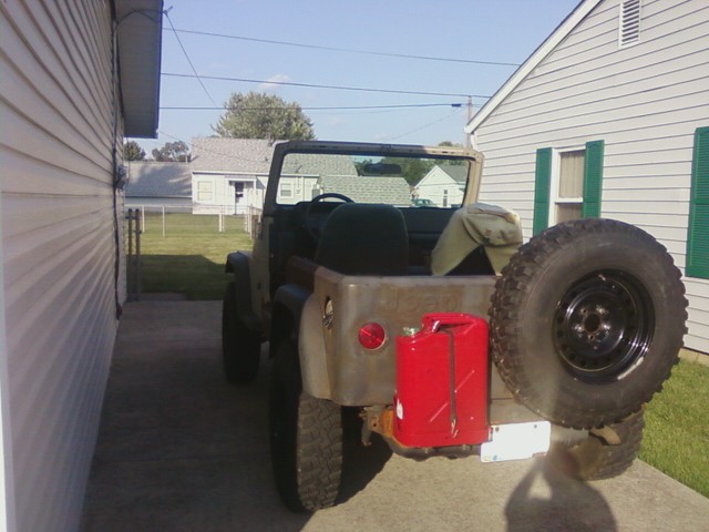

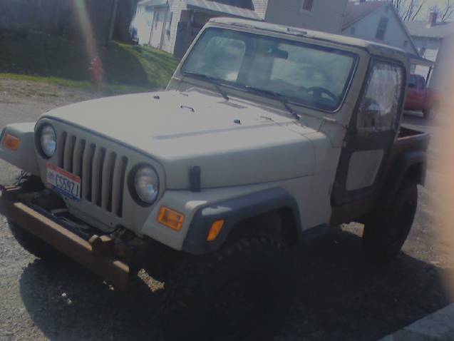

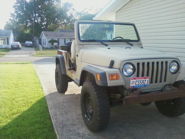

roll bar removed,2.5" lift with 33's,i could run 35's with no problem,4.0,5spd,rear metal work is 12ga armor plate (with 1/8" plate underneath)will stop a 7.62 round cold
wheels are 99 explorer 16x7s,i run 235/85/16s,E rated,60lbs of air on the trail,never got stuck,never had a flat,bone stock underneath except for 2.5 lift kit.with the wheel combo i could easily run 35s with less than 100$ invested in the kit.lost my shop in the divorce,so i havent had the time or place to finish it
front bumper is double wall 1/4" plate rectangle stock with 1"bar stock behind it,front tow hook stands i made from solid weld,still not finished..the spare tire carrier i made from a old cj swing out carrier.where the tailgate used to be is 1/8"plate on the outside,1/8"plate on the inside with 1" sq stock inside
being a army vet i wanted to do a tribute to the old army jeeps,i painted it iraq desert tan just the hummers used in iraq,but when i go to repaint it im gonna use the correct olive drab used circa 1952 M38/korea era army jeep..
forgot to mention i cut the orig tj seats down about a foot to more resemble the old army jeep seats,i need to have them recovered.i also modified the orig roll bar so that the seat belt mounts are below the seat and not visible but still very fuctional.i kept my old army bag from boot camp and use it as a pass seat cover,its badly faded from the sun but still legible
