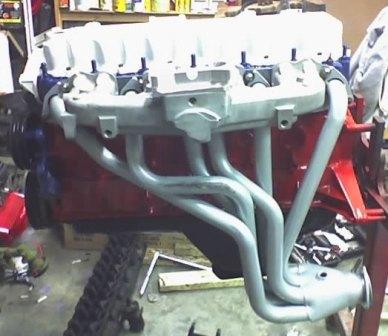

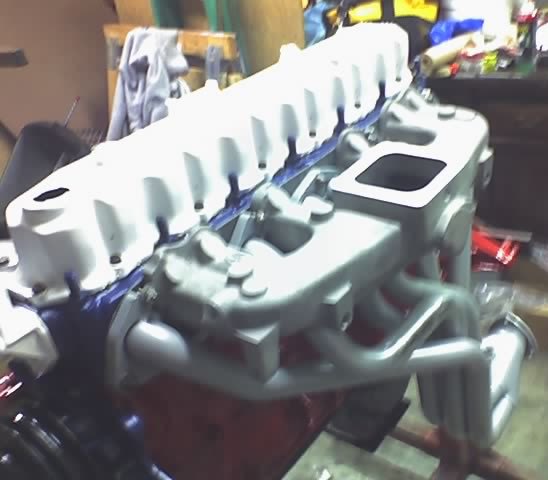

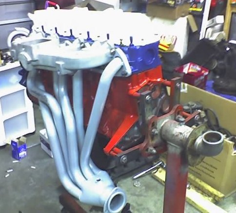

Well I got the motor back together.... :D
here are some pick of the process

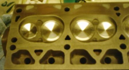

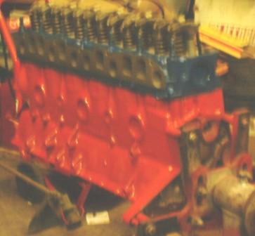

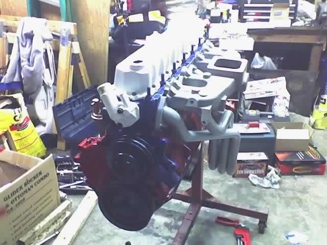

More pics
