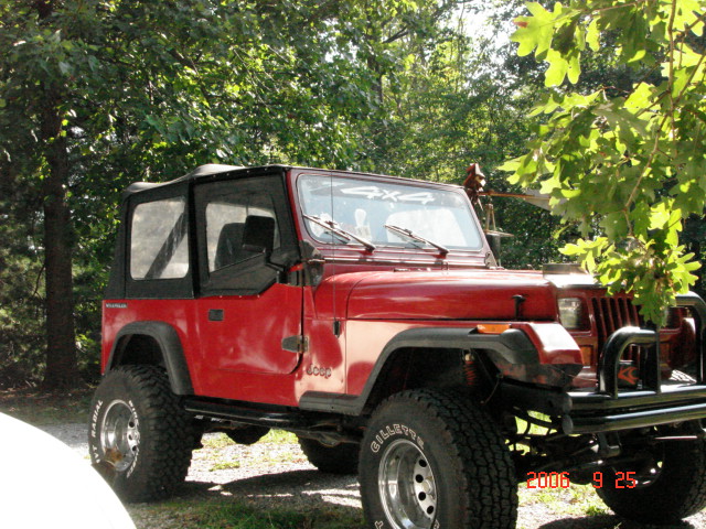

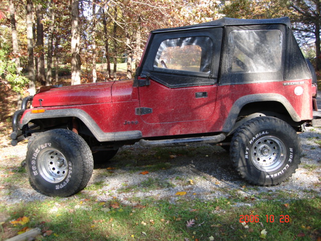

Here are a couple of pics of my Jeep...
[/ATTACH]...... Shoe Creek 025.jpg
Tina

Mighty fine looking YJ you have there Tina! Welcome 2 Jeepz.
I gotta ask... I see you have different tires front and rear...
They are the same size aren't they?
Yes they are different tires.....the front are radials and the back are all terrain....but they are the same size tires.
The back ones are the orginal tires that were on the Jeep when I bought the Jeep but the front ones....my stepfather bought me to put on the Jeep...he had borrowed my Jeep for about a month when his vehicle broke down. So ask thanks for letting him borrow the Jeep....he bought me those.
I would have bought the same kind as on the back...but I couldn't turn them down. So I went ahead and put them on. When the back ones wear out....I will put more radials on the back so that they match.
Have a great day...
Tina
Just making sure they were the same size. If not it could damage the Jeep when using 4WD.
If you continue to get into offroading, you might want to stick with an all-terrain or mud terrain as opposed to regular old street radials. The right tire can make a world of difference offroad ;)
