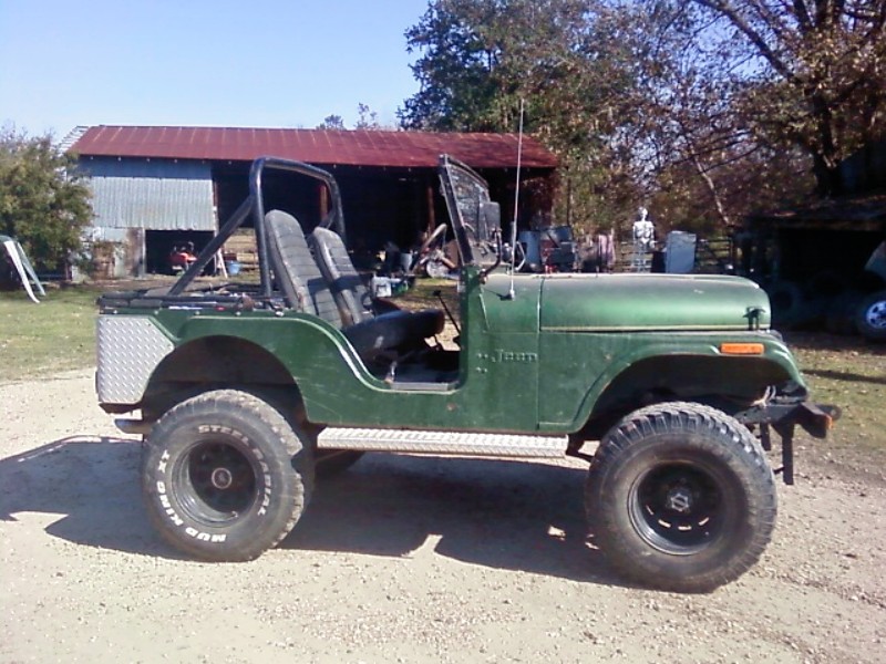

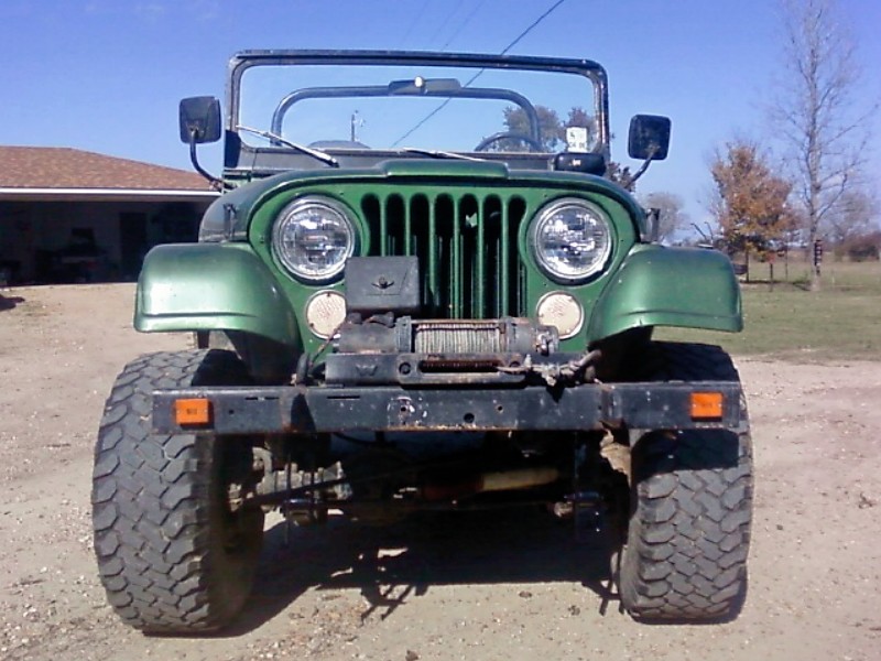

hey ive got a 73 cj5 that my dad got for me when i was 14.. im 21 now an wanna start buildin on it.. im wondering if this is a good jeep to start with or would i be better off gettin a different one.. pro an cons? is it easy to mod? is their much for it? all answers appreciated thanks, Caleb

Welcome Caleb!
Looks like a great Jeep, definately a keeper!
For 75 and down, just a little more challenging to buy parts for, but certainly not impossible.
What engine does it have?
You have a nice classic CJ there. Looks pretty solid, too. Definitely worth fixing up. Looks familiar to me for some reason... Have we seen these photos before??? Best of luck - John

The 1972 to 1975 series all come with a C channel frame (not boxed) except at the motor mounts and is prone to cracking, particularly just behind the motor mounts, all fixable but something to check out on your ride. At some point in time it probably will behoove you to just box out the rest of the frame.

I would be thinking about boxing the frame first but before you do drop your jeep off at a good frame shop and have them straighten it out and then do the work right away before it moves again on you. It could just be the picture and how the jeep was sitting on the ground but it looks to me like the front end sits up a little bit.
