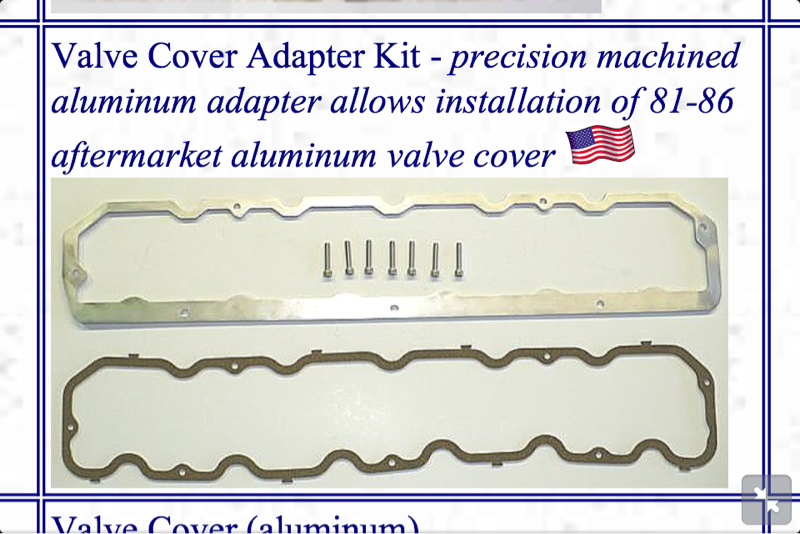

I did find an adapter to use an 81-86 valve cover on my 74!? Anyone have any experience with this?
